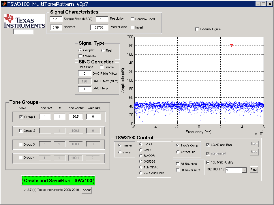

  • Aswath,
    The DAC output goes through transformer to the SMA connector so low frequency or near DC signals are attenuated. Try some frequency beyond the cutoff of transformer. e.g. the attached snapshot illustrates generation of a 30 MHz tone at 120 MSPS data rate. TSW3100 and DAC5682z EVM user guides illustrate with figures how to generate data for the EVM.
  • Hi Hamza,
    Thank you for you reply. Yes I did realize that low frequency signals are not really reconstructed properly. However, a problem I face is that even high frequency signals of the order of 30 Mhz and more are not reconstructed correctly.
    For example the above settings which you suggested for generating 30MHz sine wave returns a sine wave but of frequency of around 13 MHz, as attached in the figure below. Initially I thought my scope wasnt functioning well but later after checking, I'm reasonably sure that my scopes here at TI labs are good.

  • Aswath
    Your configuration for EVMs for getting the desired output is incorrect.
    First, Your DAC clock is 80 MHz and you have set the DAC for 2x interpolation, that means your data rate into the DAC is samnpled at 80/2 = 40 MHz (fDATA = fDAC/INTERPOLATION). Therefore, the TSW3100 GUI should have sampleing frequency 40 MHz instead of 120 M. Then 30 MHz IF is too high for 40 MSPS so lower it to 5 MHz.
    Then the Y2 divider in the CDC settings need to be set to 8.
    Since your fDATA is slow (less than 125 M), as per the datasheet, you have to disable the DLL.
    I strongly recommend you to go through user guide of DAC5682z EVM and construct the example setup mentioned there to learn all these steps.
