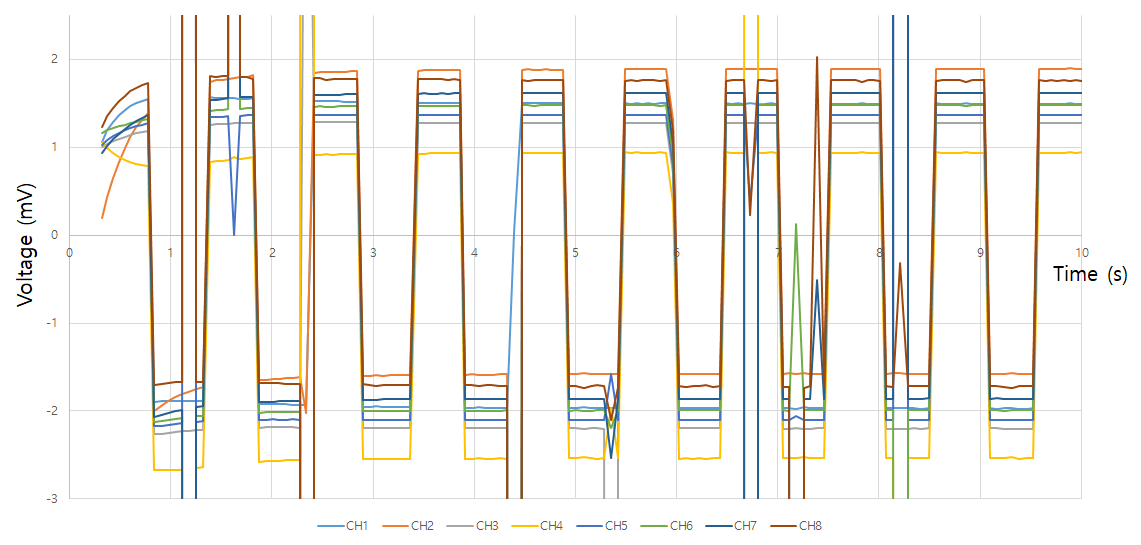

1. Signal outlier is showing on every setting  even internal test signal.
When I check the internal test signal, registers setting:
CONFIG1 = 0x96
CONFIG2 = 0xD0
CONFIG3 = 0xE0
CHnSET (All channals) = 0x05 (not floating, connected to AVDD)
And checked values (VCAP checked with closest capaciter):
VCAP1 = 1.19V
VCAP2 = 2.5V
VCAP3 = 6.87V
VCAP4 = 2.27V
VREF = 4.48V

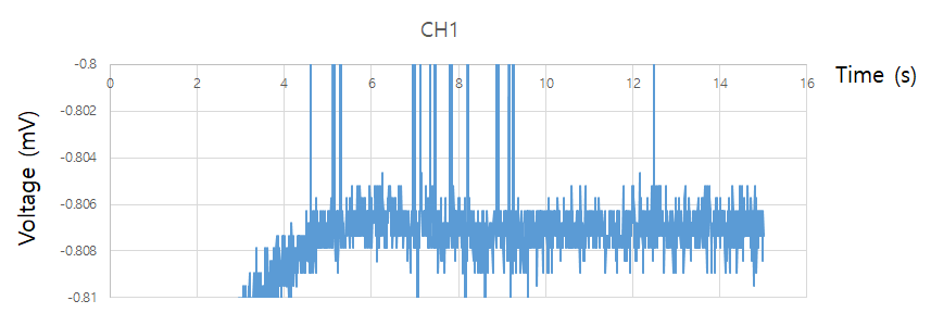

2. I didn't have any output when electrodes are attached to skin(muscle).
When I check electrode signals, I focused on only Ch-1.
My setting:
CONFIG1 = 0x96
CONFIG2 = 0xC0
CONFIG3 = 0xE0
CH1SET = 0x30 (I checked every gain)
CHnSET(Ch-2~8) = 0x81 (not floating, connected to AVDD)
VCAP1 = 1.19V
VCAP2 = 2.5V
VCAP3 = 6.87V
VCAP4 = 2.27V
VREF = 4.48V
My signal was showed that:

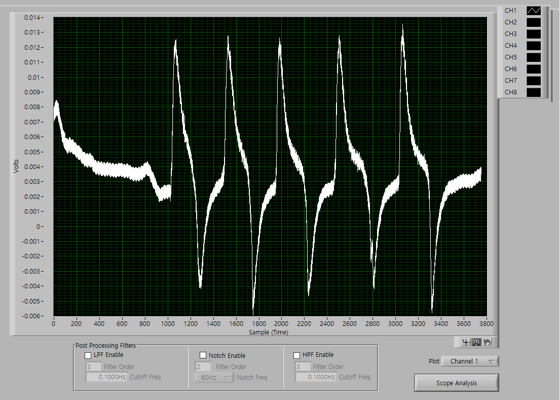

I have ADS1299EEGFE-PDK. Using this domo kit and in the same electrodes and behavior, signal was showed that:
I don't know why didn't make any signal without noise. I checked internal test signal, VCAP1~4, VREF, and Device ID(it is 111110, same whith ADS1299EEGFE-PDK).
How can I fix these problems?

  • Hi Woochang,
    If you have not done so already, please confirm that your code to voltage equation is correct using the BIOFAQ: https://e2e.ti.com/support/data-converters/f/73/p/772058/2855202
    Second, I would start investigating the communication between the ADS1299 and the Arduino. There very well may be a timing misalignment, that leads to sometimes having a sample truncated - which leads to erroneous readings. Unfortunately I cannot help you debug an issue with an Arduino since it is not a TI product. However, I would start with using an oscilloscope to measure the relevant SPI communication signals - see the BIOFAQ.
    Using the oscilloscope readings, checking what is actually received by the Arduino, and then verifying that the result is graphed correctly should help you identify where the issue is.
