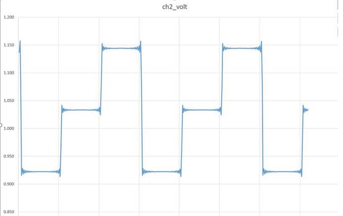

I use the ADS1278 in an application where the input signal changes in steps.
The ADC input signal is a response of a measurement device to an excitation signal created with a DAC.
The excitation signal can be changed.
I’m interested in reducing or eliminating the ringing in the step response of the ADS1278 by ‘rounding off’
the corners of the excitation signal. A simple first order low pass filter eliminates ringing after the edge
but some ringing before the edge remains.
What I’d like to know is how to ‘slow down’ the excitation signal so the edge times are as short as possible
but are not causing ringing in the response of the ADS1278.

Sampling rate of the ADS1278 in the following examples was 10kSps, the duration of each step in the test signal 5ms.
This is the step response to the unfiltered step signal fed into ADS1278 input.
This is the response to the low pass (1st order) filtered step signal. The 3dB cutoff frequency of the low pass filter
is about 1.4kHz
Most of the ringing after the step change was eliminated but there still is ringing before the step change
This picture shows the response of the ADS1278 to same filtered signal, the vertical scale is different.
I feel this is very likely the digital filter response to the step input you apply to the inputs. Figure 66 in the datasheet shows the ringing that occurs at both the beginning and the end of the step input. The conversion response starts to 'ring' immediately after the step input (conversion 1 in the below picture), but is very small at first and not easily observable when plotted from 0 to 100%. After about 35 conversions, you can start to see the response changing, and by 40 conversions the response is within 5% of the final settled value.
This ringing is proportional to the rate of change on the input signal. The RC filter response changes slowly as it approaches the final value, but the initial change is much more abrupt (slower with the filter than without, but still enough to cause significant ringing).
I am not aware of a simple analog circuit to shape the response on the leading edge, but you did mention using a DAC in the system. If you slowly change the output over the first few microseconds before ramping up to the final value, this should help with the ringing. If you can do this on both the beginning and end of the 'ramp', you should be able to reduce the ringing on both edges without adding additional components.

I would also like to add that the digital filter requires 76 conversion cycles to fully settle (78 if using high resolution mode). You mentioned you are sampling at 10ksps, so it will take 7.8mS to fully settle. Since each step is only 5mS wide, you will only get around 1% settling.

I tried slowing down the edges in a few different ways. The only way I could eliminate
the ringing after the edge was by using a low pass filter of a specific cutoff frequency.
This has very little affect on the beginning of the edge though. I can apply the same method
to the signal generation (DAC) to round off the beginning of the edge as well and minimize the ringing
before the edge. Although I was hoping that based on the ADS1278 filter characteristic
you would be able to tell what the optimum (fastest) shape of the fastest step signal that doesn't produce
ringing is.
Without knowing the filter characteristic, it's not a trivial task. I tried slowing down the edge
and rounding off the corners in a few ways with no good effects.
There may be a faster signal than the low pass filtered step that doesn't cause significant ringing.

I checked with the filter designer, and he is not aware of any simple mathematical relationship that would predict the magnitude of overshoot vs the rate of change on the step input. This may have been figured out by someone in the industry, but this is not something that we have available.
