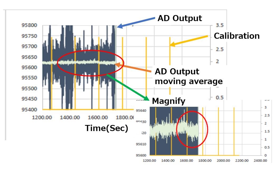

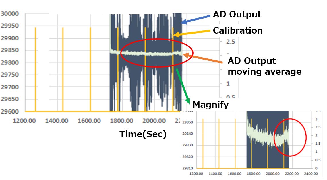

I'd like to know about Self-Calibration.
When my customer use self-calibration, they get a difference in the output data.
Could you check their waveforms?
And then, I have some questions about self-calibration.

  • Hi Kengo,
    The self-calibration will first adjust the offset by applying a short to the input and determining a value to correct for offset.  The second part of the calibration is to apply a full-scale signal to the ADC inputs from the reference to adjust for any gain error.  Any noise on the power supply and especially the reference will affect the outcome.  Also, keep in mind that the noise of the conversion process will result in varying results to be within the level of the noise of the ADC.  In other words, high-resolution mode will have lower noise than high-speed mode resulting in a more accurate calibration.
    1. Self-calibration does not need an input signal. So what does it compare to? [Bob] This is done internally by applying a short on the inputs for offset calibration and connecting to Vref for gain calibration.
    2. Is Self-calibration affected by changes in Vref? [Bob] Yes, the Vref noise and drift will affect the results, especially the gain calibration.
    3. Is Self-calibration a close to factory condition? [Bob] I'm not quite sure what you mean here, but by procedure yes.  There is a dependency on the reference voltage used and whether the buffer is enabled.  As a full-scale input voltage will be applied I would disable the buffer (if enabled) when calibrating to avoid error due to the buffer.
    4. Is there a frequency recommendation? [Bob] The self-calibration should be done following device power-up after the supplies have reached nominal operating voltage and the reference is fully settled.  Also, after any device reset.  Any calibration done following power-up and reset will depend on how much the temperature of the ADC and reference may drift over time.  There is really no guidance to be given as this will depend on the system to which the ADS1225 is deployed.

  • Hi Kengo,
    I'm not totally clear on what you are asking.  What do you mean by the timing of the calibration?  Are you asking how long the calibration takes to complete once initiated?  Or are you asking about how often you need to calibrate?
    The offset and gain will change with respect to operating temperature of the ADS1225.  This would be temperature drift as specified in the ADS1225 datasheet in the electrical characteristics table under System Performance.  The same would be true with respect to the gain error due to reference drift and would be an additional error.  To reduce the error you need to issue the self-calibration routine.
    As I mentioned in my earlier post, the need to issue additional calibration(s) following power-up will depend on the temperature stability of the system.  That is something I cannot answer.
