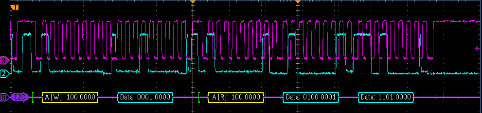

Picture shows my read process:
1. byte: slave adress (write mode)
2. byte: read data command
3. byte slave adress (read mode)
4. & 5. byte: data from the ADC (crap)
End: no stop condition, the ADC hold low level on SDA line
Have someone an idea what I do wrong?

    The data being returned is 0x41D0 or 16848 decimal.  If you are using the external reference of 1.8V and a gain of 1, the value of a single code is +/- 1.8V/2^16 = 54.93uV.  The value being returned is the number of codes times the value of 1 code which for this example is 925.49mV.  As I have no idea what the actual input voltage is or how it is connected I cannot tell if this is close, but it is more than 500mV.  So I think you are making an error in your calculation.
    Also, you must make sure that the input voltage to the ADC is within the input range for the measurement.  If you are making a single-ended measurement (which is a measurement with respect to AGND) and if you are using a unipolar analog supply (AVSS is connected to AGND) then you must also disable and bypass the PGA.
    As to the SDA being held low at the end of the communication, this is a read operation by the micro which is holding SDA low and not the ADS112C04.  This would be most likely caused by the micro not sending a STOP command.

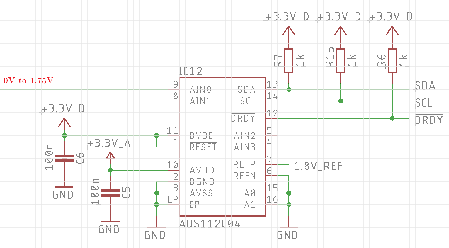

    My schematic:
    The I2C commands with them I work (register settings, slave adress and command bytes):

    Input voltage on all analog channels is 0 to 1.75V (no negative voltages)
    I send a stop command in the end, that's why I am also confused.

    As far as the micro not correctly completing the STOP condition, I would verify that your function  i2c_receive2Byte() is working correctly.  The ADS112C04 will only ACK when receiving data and will not ACK when transmitting data.  This ACK will come from the micro.  As the micro is not effectively stopping as it should something is incorrect in the procedure.  Normally the micro would NACK the last byte received and then go to a STOP condition.  So as the micro sent an ACK, it would appear that the functionality within the receive function is anticipating another byte to be read instead of stopping.
