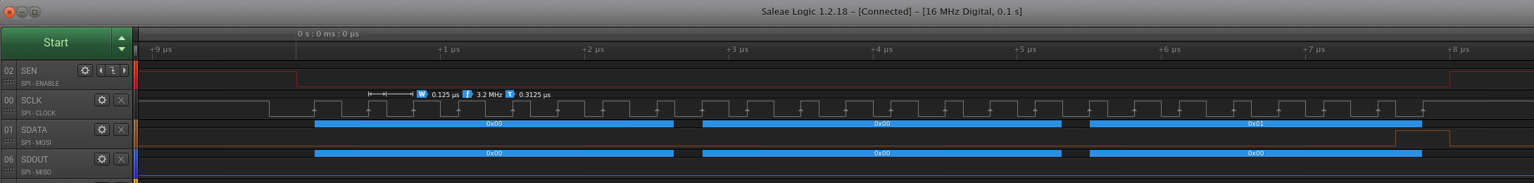

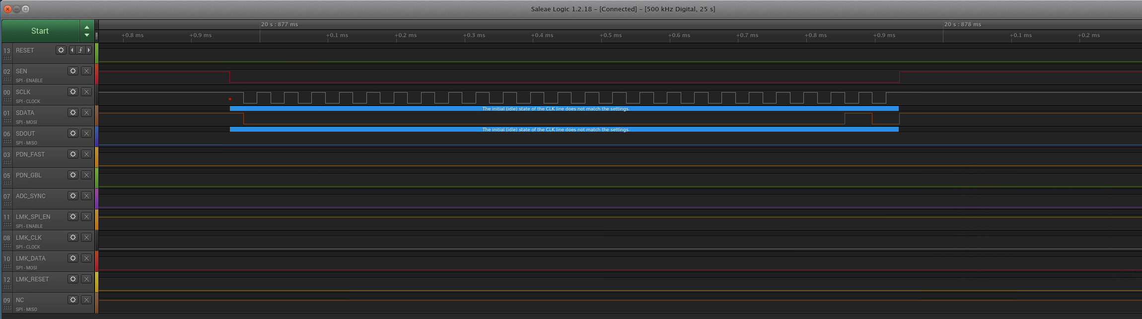

To summarize, I'm having trouble communicating with the ADS52J90 chip on the ADS52J90EVM board. I do NOT have the TI supported host FPGA cards (TSW14J56EVM or TSW1400) connected. Instead I'm connecting the ADS52J90EVM to a ZC706 board. I'm using the FTDI D2XX library and some C code to control the SPI bus in a bit bang mode. I'm fully aware that I will need to setup all the register settings in the ADC and clock distribution chip myself without the supported host boards. However, I can't get the ADC to read back any registers to confirm that my register writes are correct.
My test is the following.
1. Write address 0x00 = 0x0001 to reset the ADC chip
2. Write address 0x0A = 0x3000 to initialize the ADC chip. This step is specified in the ADS52J90 datasheet.
3. Write address 0x01 = 0x0094 as a test of the register writes. This should configure the ADC into 16 channel input mode.
4. Write address 0x00 = 0x0001 to enable register readback mode.
5. Read address 0x01.
6. Read address 0x00.

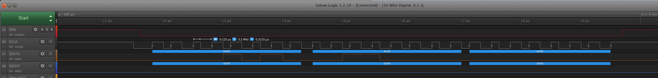

The problem is that every read that I perform, I only see SDOUT (SPI-MISO) as 0. I have the SPI bus pins probed with a logic analyzer to confirm the transaction is according to the datasheet. I have even double checked that the logic analyzer is reading the SDOUT test point correctly by probing with an oscilloscope.
I suspected two things in my original thread that I have since tested.
1. Maybe the ADS52J90 requires a system clock for the registers to work properly.
I connected a signal generator with an 80 MHz clock output to J75 SMA input of the ADS52J90EVM. I reran my SPI test and got the same result. SDOUT always reads back 0.
2. Maybe the ADS52J90 has a minimum SCLK speed even though it is not listed in the datasheet.
My original test used a python script to bit bang the SPI transactions and it ran very slowly. SCLK was around a few kHz. I have since updated my test code to C and use the FTDI D2XX library. SCLK is now running around 3 MHz, which is less than the maximum of 20 MHz specified in the datasheet.
What am I missing? At this point, I'm starting to think the ADC is broken.

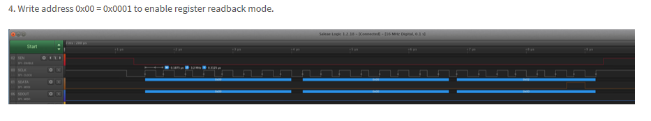

    Thanks for sending us very clear information.
    For the following address setting (please see next):
    Could you please see the following modification and notice.
    0x00 (this is used for setting SDIN pin)
    0x0001 (Please needed to change it to be 0x0002) and (this is also used for SDIN pin).
    is it OK?
    then after that, you can try to run at your Step 5.:

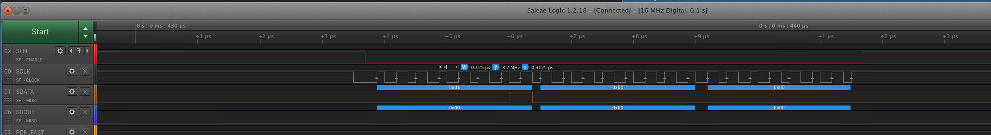

  • Sorry for the confusion. My step #4 had a typo in the description. It should have read ...
    4. Write address 0x00 = 0x0002 to enable register readback mode.
    If you look at the waveform attached, you'll see that I set the correct bit for enabling register read mode.

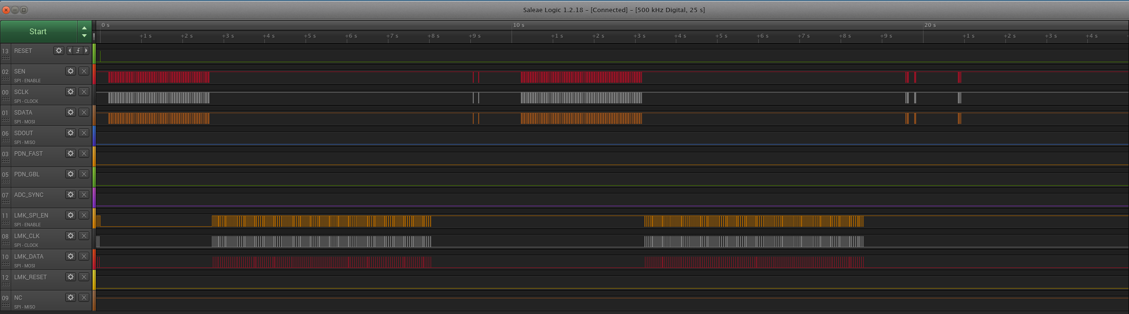

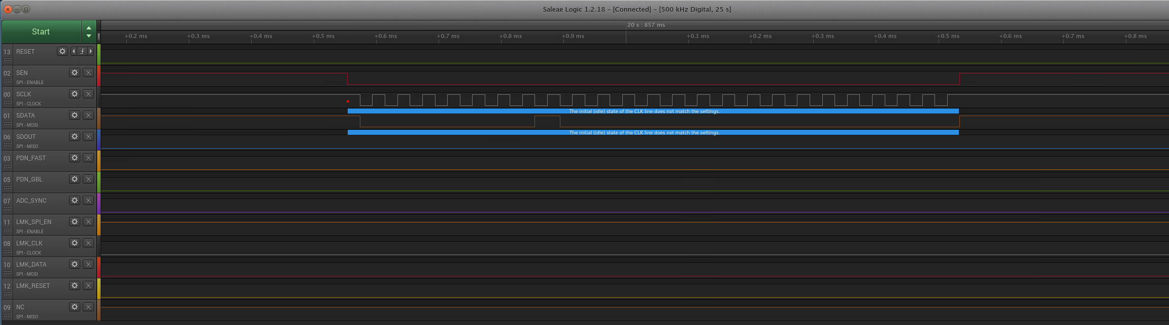

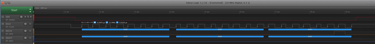

    I spent more time reverse engineering the TI software configuration waveforms of the ADC and LMK chips. As far as I can tell, my SPI bus transactions match the TI software to configure the board with the LVDS 14-bit example in the user guide. I'm still unable to readback any register values with my FTDI c code. Below is a zoomed out capture of the configuration of the ADS52J90EVM using the TI software.
    Here is my waveform generated when connected to linux and running my FTDI C code. At the very end of the capture, I added three read transactions for addresses 0x01, 0x02, and 0x03. All 3 addresses readback 0, but I'm expected to see address 0x01 = 0x0014, 0x02 = 0x0000, and 0x03 = 0x2000.

    1. 1. I matched the TI GUI software pattern of writing address 0x00 = 0x0002 before every read transaction.
      2. If you look back in the forum thread, I responded to this issue. The description has a typo, and the waveform shows the correct write of address 0x00 to value 0x0002. Here is an example of the read sequence for address 0x01.
      Then, read address 0x01.
      3. Here is my current C code to configure the ADS52J90EVM to match the TI GUI software. I've added 3 address read transactions at the very end of the sequence that still always read back 0.
      ads52j90evm_config.tar.gz
    2. Hi,
      We have forward your information to our engineer for checking.
      Thank you!
    3. Chen Kung was able to send me some example C code using the FTDI D2XX library to write and read back one of the registers. This worked flawlessly and I was able to compare the differences of this example code to my code.
      The critical difference was that I was not setting the RSV_DIG (connected to ADS52J90 pin labeled SPI_DIG_EN) pin high. When SPI_DIG_EN is set low, the SPI SDOUT pin seems like it is stuck low. This doesn't seem to be documented in the ADS52J90 Datasheet nor the ADS52J90EVM User Guide. This is the only note that I see in the ADS52J90 datasheet (Pin Functions Table on pg 8) is shown below.
      “SPI_DIG_EN,    B6,    I,     Reserved for digital functionality. This pin can be left floating or be connected to the 1.8-V supply. This pin has an internal pullup resistor of 20 kΩ.”
      Given this note, I probably should have assumed this pin needs to be pulled high with the FTDI chip on the ADS52J90EVM, but this is not clear at all. I hope this saves someone else some trouble when using the ADS52J90 or ADS52J90EVM.
