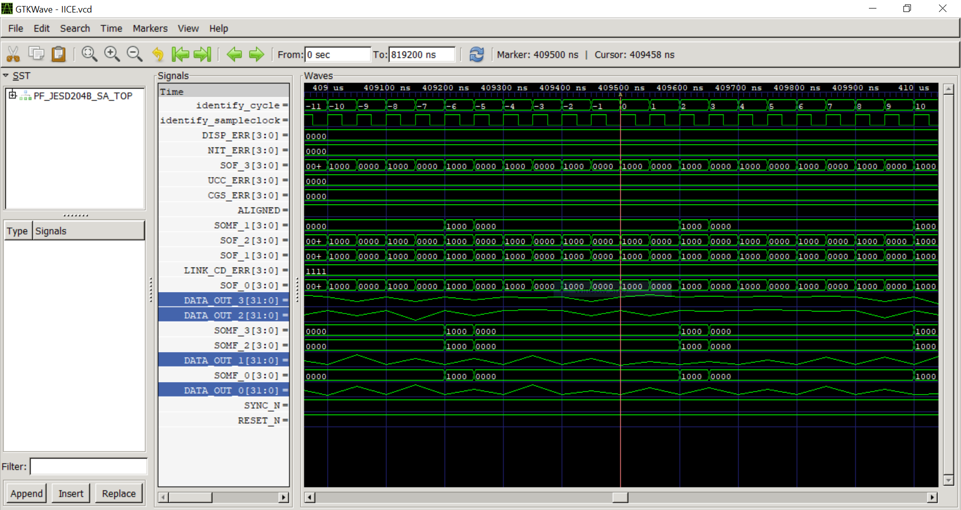

  I am doing interop test using AD12DJ3200 with microsemi Polarfire FPGA. I have configured ADC for JMODE2. I set JESD TEST Mode to Normal operation (default) , giving analog input 1vpp , 1MHz sine wave. But i am observing noise instead of Sine wave. In ADC GUI i am just setting Fs =1250Mhz, clock source is on board and JMODE is JMODE2. Is this setting enough or do I need to do any other settings in ADC GUI?
I checked ADC register status (208) , link is up and PLL locked. Even I have tried other test modes like Ramp test mode and transport mode. These modes are working fine. When I am giving analog input from function generator instead of sine wave i am seeing noise. Please provide sugggestions to proceed further.
Is any configuration settings am I missing?

    1. JMODE2 is dual channel mode can you please make sure you are applying the analog input to correct channel.
    2. When you are changing test pattern mode from ramp to normal mode can you please confirm you are disabling the JESD block Enable before making the change and enabling it afterwards?
     I have connected my cable which is coming from function generator to VINA (single ended input) of ADC.
    Yes. I am disabling JESD block enable and then changing the test mode and again enabling it.
