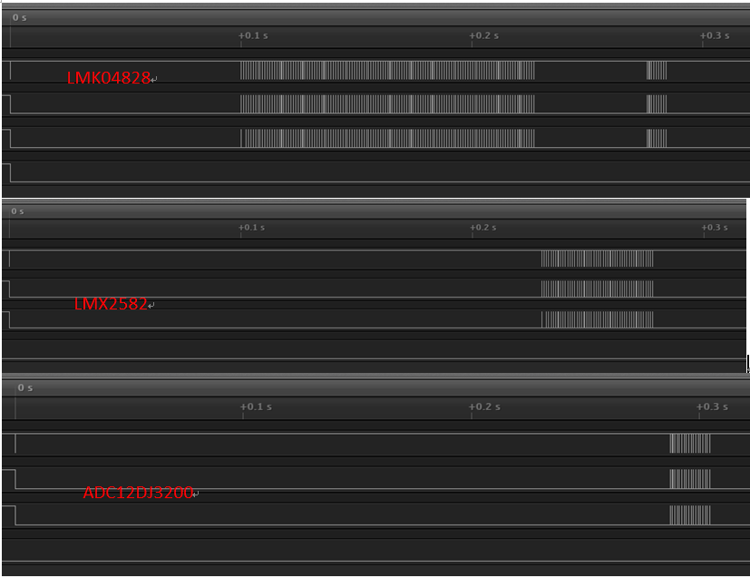

I have a question about the initialize stable time for the ADC12DJ3200 before FPGA is configured.
At first, I use a USB-SPI adapter to configure the LMK04828, LMX2582 and ADC12DJ3200, and then configure the FPGA, everything goes well.
Then I use FPGA to generate SPI signals to configure the LMK04828, LMX2582 and ADC12DJ3200, that means after the FPGA is configured, all 3 chips is configured sequencially, and then the JESD204B is ready to work. I assume this will work. Actually not. Because I ran an PRBS23 test, which appears No Link. The clock is OK, I can see 3.2GHz via Spectrum. And I can see SYSREF also.
The only difference between the above two method is: The time between SPI using USB-SPI adapter and FPGA configuration is about several seconds. While the time between SPI using FPGA logic and JESD20B RX logic maybe immediately. So I'm guessing is there ADC initialize stable time requirement that I need to add several us/ms delay bebore the JESD204B RX is ready to work?
BTW: the SPI clk is 1MHz, S configure timing order is:When FPGA is configured,wait 100ms,then configure LMK04828(~126ms), LMX2582(~48ms), LMK04828(~9ms),ADC12DJ3200(~18ms), just like this picture:
the register map for PRBS23 test is provided.

  • It is a bit tricky to answer.  There may be some time needed for the individual clock chips to settle in order properly feed clock/reference into the subsequent stages.  We will look more closely at the enclosed SPI timing plots. --RJH

    Thanks. However, I dump out the ADC12DJxx00 GUI timing order out of FT4232, just like this:
    LMK04828(~1.94s)
    wait(~1.356s)
    LMX2582(~1.03s)
    wait(~0.01s)
    LMK04828(~0.13s)
    wait(~0.89s)
    ADC3200(~0.18s)
    Total length: ~5.6s (SPI Clock: 3.125MHz)
    So I will try to add some interval between the configuration of LMK/LMX/ADC. Trying to emulate closely to this situation.
