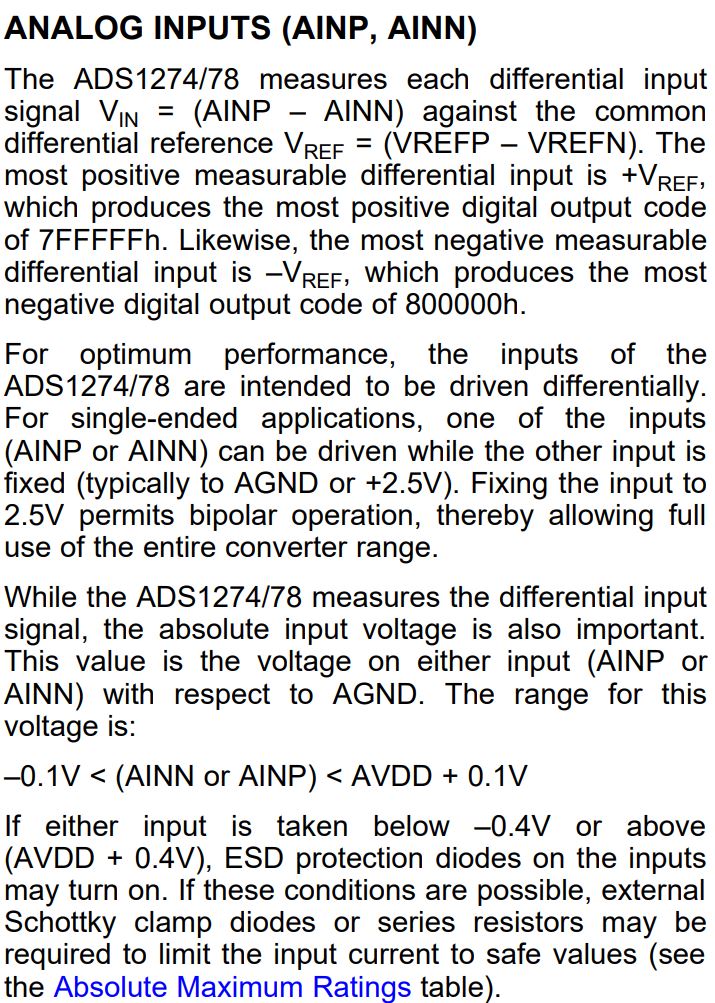

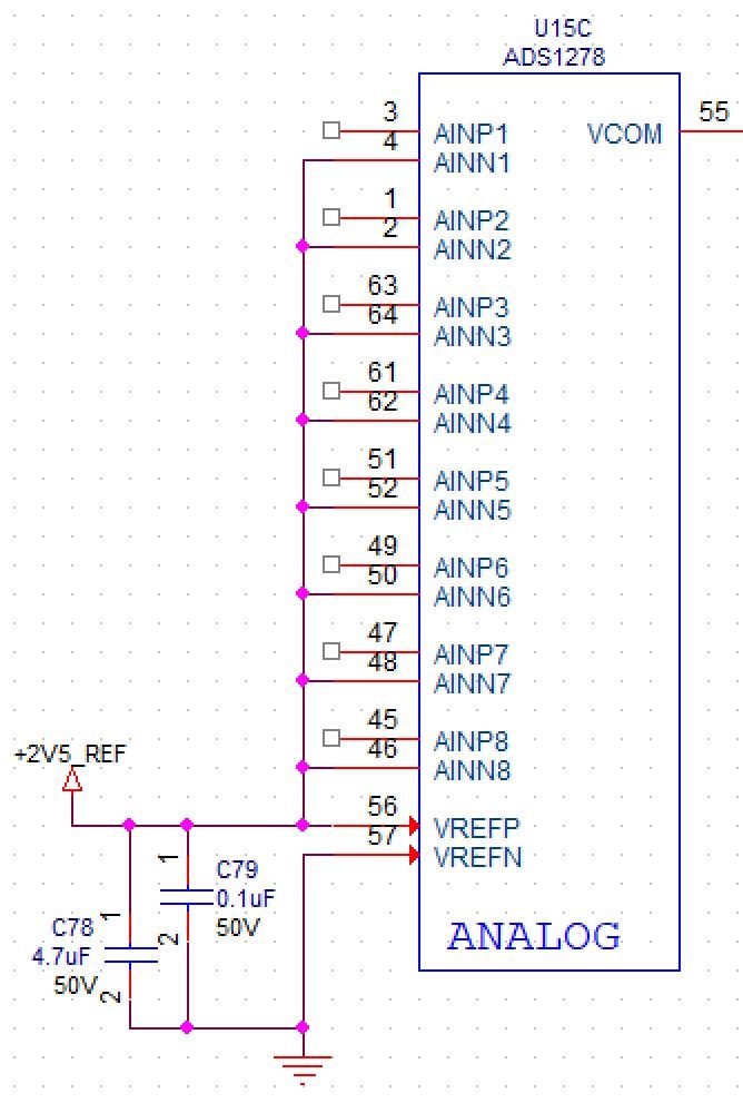

The datasheet hast the info below. My question is how do I properly drive the AINP input if I have AINN connected to a reference voltage of 2.5V (See below)? To get the full converter range do I drive AINP from 0 to 5V or am I limited to driving 0 to 2.5V it is not made very clear.
Thanks;
Leo
