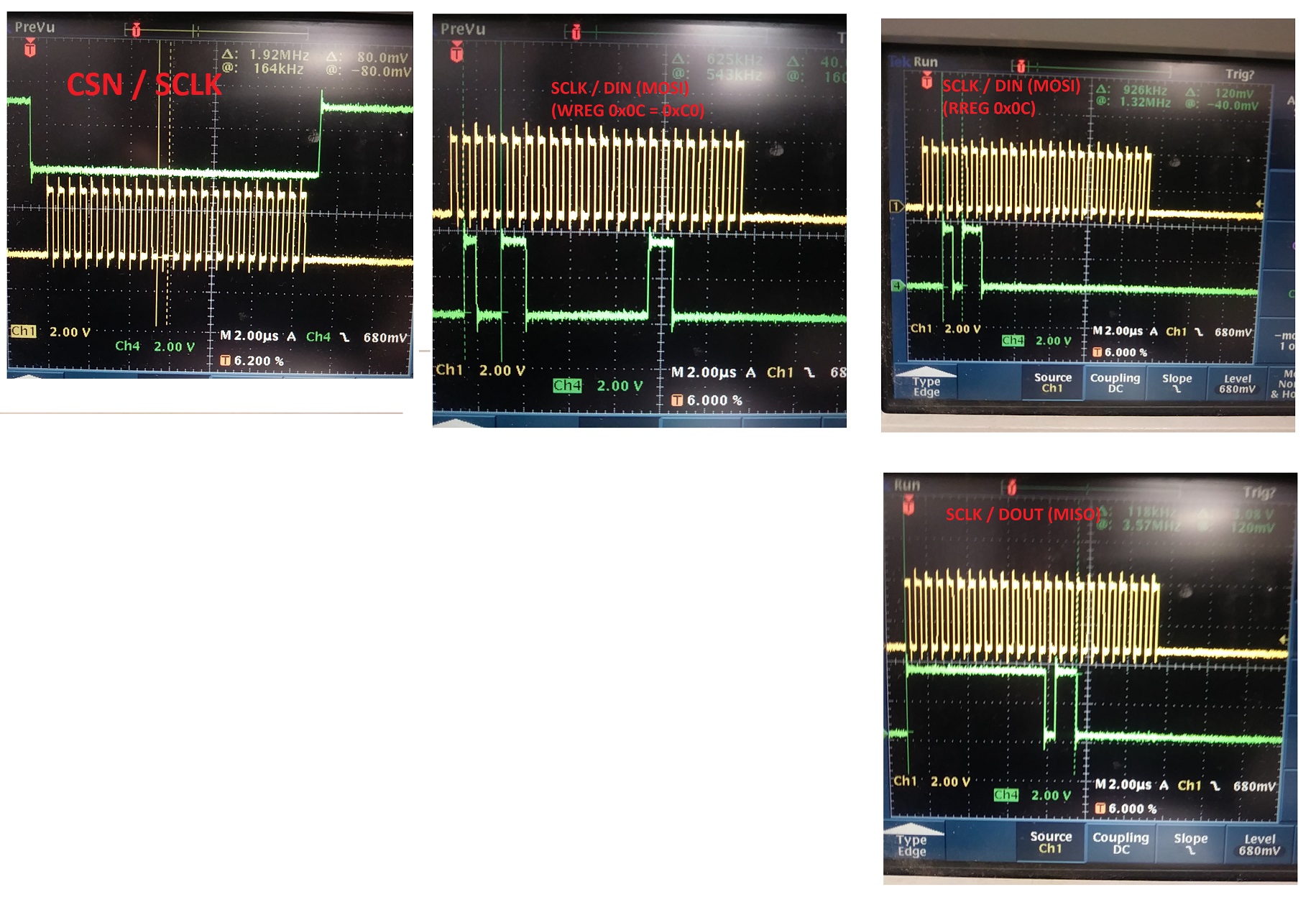

  • Verified the CLK pin is grounded and that NRST and START are both high.. and while the data returned is always 0, DOUT does show activity before the data!
    The following sequence shows a WREG command to the GPIO CFG Register (0x0C) with a data value of 0xC0 (AIN6 and AIN7 set for GPIO) ,  followed by an immediate RREG of the CFG Register (0x0C).
    Not shown for the data captures, but CSN surrounds each set of 28 SCLKS as shown in the first picture.  The bottom right picture happens during the same time as the top right picture.. and shows DOUT has activity on the first 16 bits, but 0 for the data (where the expected is 0xC0).
    It looks as if the chip isn't seeing DIN, despite being present at the pin.  I've tried adjusting the time between CSN and SCLK, the SCLK frequency, and changing the data on the rising/falling edge..   Nothing seems to get the chip to react.

    As a fresh start, please try setting the SCLK frequency to 1MHz. We know for a fact that this frequency works with the ADS1248 with no issues.
    We do in fact see data coming out of the ADS1248, as shown in the bottom right picture. The ADS1248 defaults to continuous conversion mode (RDATAC) as the result is automatically placed in the transmit buffer. As soon as SCLKs are received, data is transmitted out. Regardless of sending a RREG or WREG command, the dat will be transmitted out for the first 16 bits (MSB and MID-BYTE). ). If the command is WREG, the whole conversion will be transmitted.  If the command is RREG, then only the first 16 bits are transmitted because after the RREG command is decoded (Command and number of bytes) the Output buffer will be updated with the new register information.
    With the RESET pin high and the START pin high would highly recommend that you try the RREG command for register 0 as the very first operation after power-up with no register writing or any other commands.  The default value for this register is 0x01.  And it would be good to see a scope shot of that communication.
    Next, try issuing the SDATA command to see if this command works. Once this command has been sent, you can verify it is working by reading various registers and you should no longer see the conversion data in the output register when SCLKs are transmitted. We would like to see a scope shot of this communication.
    If this is working, then try WREG, and read it back with RREG.  We would like to see a scope shot of this communication.

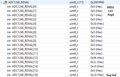

    Next the SDATAC command is sent ( 0x16) and the MISO line returns : 0xFE.
    Finally, reading Register 0 in a loop, I see the MISO line traffic is:  0x00, 0x00, 0x01.    (The chip correctly seems like it's no longer converting.. interestingly, the read immediately following the SDATAC I see non-zero data on the first couple bytes.. presumably this is old data)
    Unfortunately, doing a write to GPIO CFG register (0x4C, 0x00, 0xC0), and then commanding a read (0x2C, 0x00, 0x00), the MISO line returns 0x00, 0x00, 0x00.    Similarly, writing other (IDAC , GPIO DIRECT, MUX0), all behave the same.. they don't return the value being written to them.

    4) Read Reg 0 command , the MISO line returns:  0x00, 0x00, 0x01.   Interestingly, the first time the register is read after SDATAC is sent, the first 2 bytes are  non-zero.   Also NDRDY continues to toggle.
    Unfortunately, writes to any register (ex. MUX0, IDAC0, GPIOCFG, GPIODIR, GPIODATA, etc) the RREG data returned from the registers suggests the data written wasn't latched.   For example, writing Inputs to GPIODIR (0x4D, 0x00, 0xFF) the RREG command (0x2D, 0x00, 0x00), has MISO returning:   0x00, 0x00, 0x00,      The silicon revision field returns 0x9.. is there any known issue with DIN data not getting latched?

  • Attached is a screenshot of CSN, SCLK (<1Mhz), MOSI, MISO immediately after power-on, with 3 commands:   RREG to 0    (data returned is 0x01),   a WREG to register 0x0E with the value of 0x40 , followed by a RREG from register 0x0E.
    Zooming in on the CSN, SCLK, MOSI, there is no glitches or spikes that can be seen.
  • Hi Parker,
    Your communication is correct but it looks like there is some over/under shoot on your communication lines, which may be causing a problem. If you have not done so already, I would try adding a small resistor (~10-50ohm) close to the signal source and a small capacitor (~30pF), near the receiver to smooth these transitions. One other thing to look into is the drive strength of the uC. You can try turning is down to ~2mA to see if that helps as well.
    If you share the layout I'm happy to take a look at that as well.
    Here are some scope shots we took on our side:
    RREG 0, default settings:
    WREG 0:
    RREG 0:

  • With the workaround in place, the register read back contains the data written:
    Once initialized, we minimize the number of writes/retries, by only updating the MUXSEL  :
    0x40 0x00 0x01
    0x40 0x00 0x13
    0x40 0x00 0x25
    For now the PGA, REF, and IDAC settings will be the same for all channels.
    However, despite seeing ~2V at R35, the adc data is either zero or 0xc00000..  regardless of the voltage across CH0/1 & CH4/5,  or the RTD resistor across CH2/3.
    It's possible it's still a lingering issue with the flakey SPI communication, but is there anything from the register setup that could be the cause?
