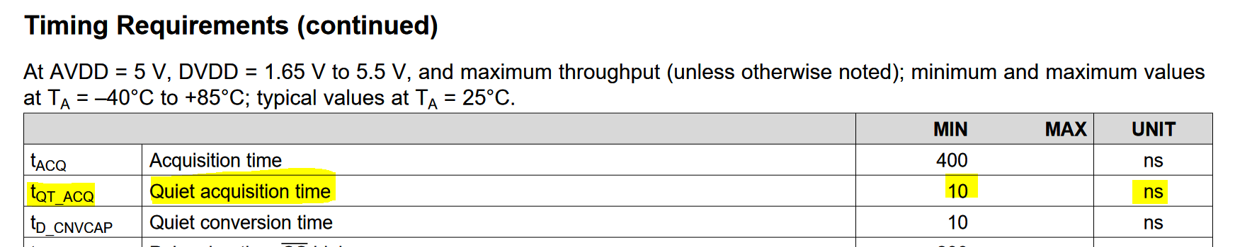

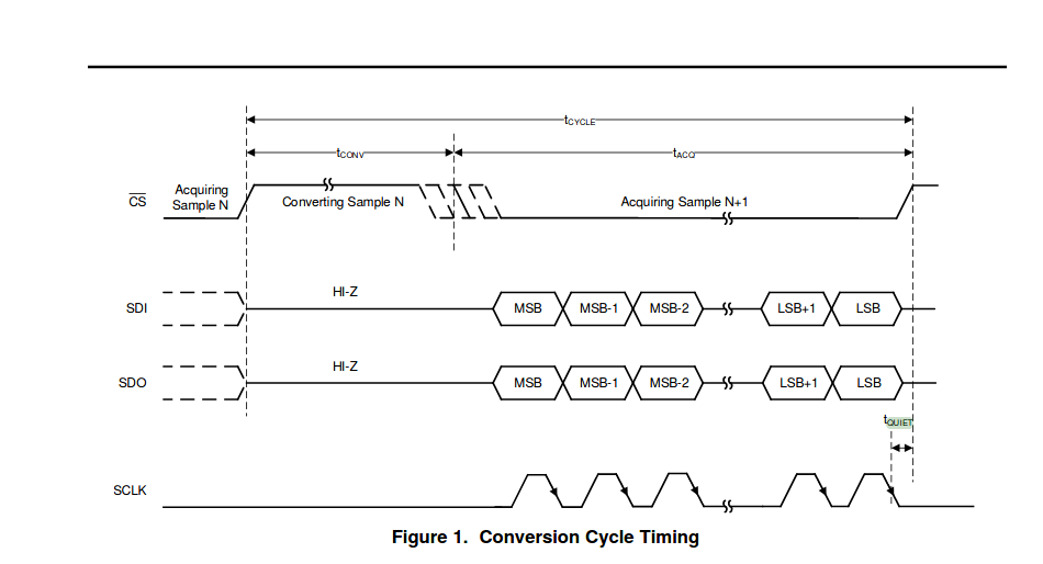

I am using TLA2518 chip. there is quiet time mentioned in the timing graph but I could not find any values regarding to that in the datasheet. are there any timing constrain in between final sclk falling edge and cs rising edge?
Thank you,
