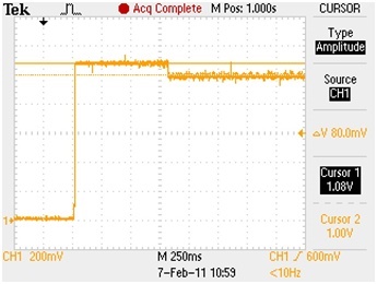

I am looking at Vref on a THS1041 at startup.  Once the chip is powered up, Vref jumps to 1.08V than after ~750ms it changes to 1.00V.  Is this how it is supposed to operate normally?
  • We did some test on Vref, it reaches its spec level about 1ms after power supply reach certain level, Vref is stable about 800ms late (tested). In your case, I would say it is normal because the voltage change is in the initial time (<800ms) and it is stable at 1v after 750ms. However, in your case the voltage stays at 1.08v for some time then jump to 1v looks like that there is digital activity going on in the system during the time. For example, change the state of the logic pin Mode or state of the register.

    We do write to the register, but it happens after the voltage settles to 1.00V
