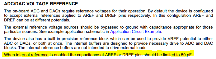

Hi Sirs,
As title, do we need external bypass capacitors on AFRE and DREF pins when internal reference was used? Can we leave them open?
Thank you and Best regards,
Wayne Chen
