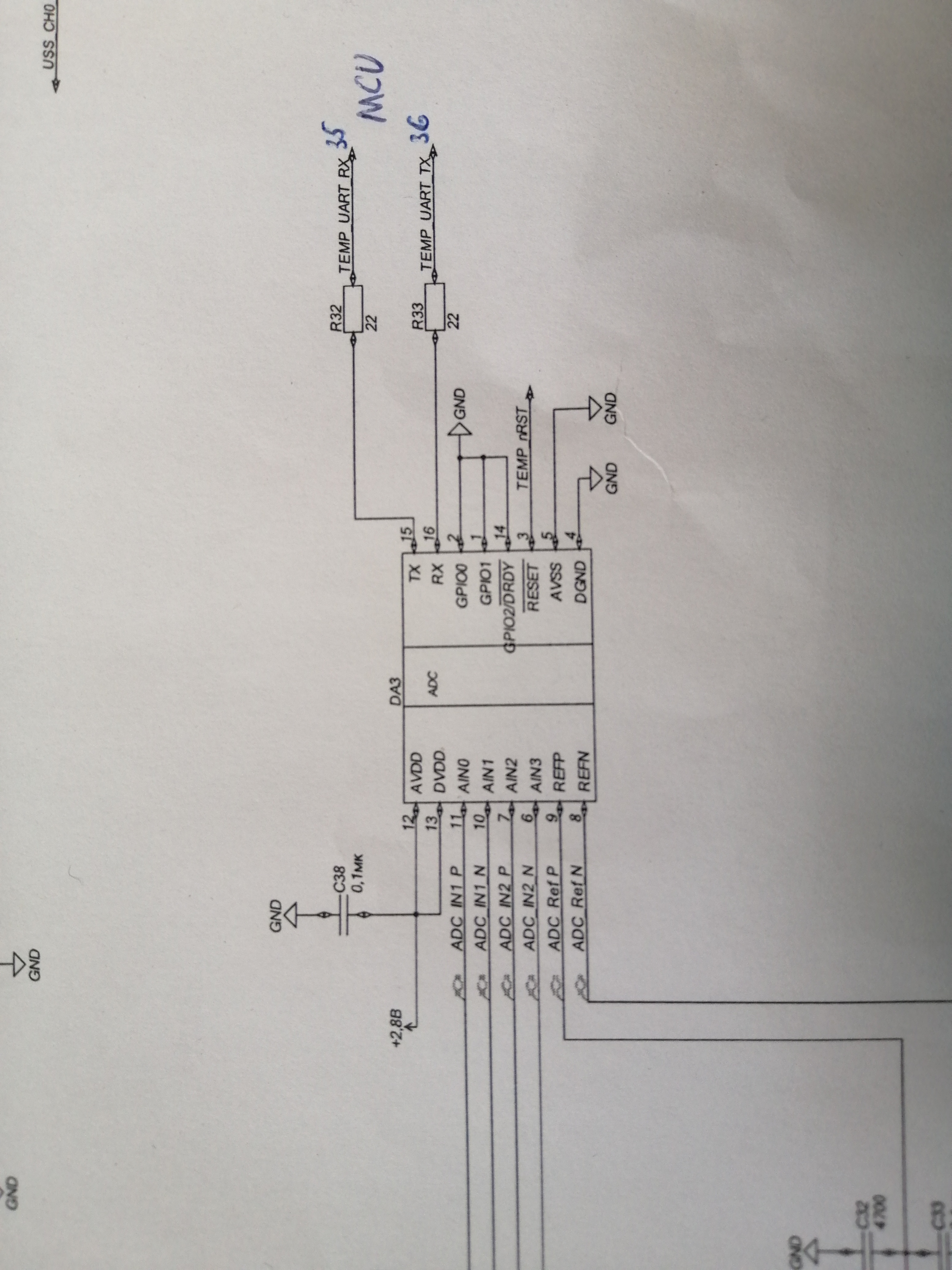

Hello
I have problem with reciving data from ADC`s register. The code may send commands to  ADS122U04 via UART from MCU. But when I use commands from datasheet to set registers or read they value happens nothing. The code placed lower.

  • Hi user6244799,
    Can you send me a schematic?  Make sure that TX from the micro goes to RX pin of the ADS122U04 and TX from the ADS122U04 goes to the RX pin of the micro.
    I reread the previous post you sent, and I didn't fully answer the questions.  Regarding RESET, there are two methods to reset the device.  One method is to toggle the RESET pin.  In this case the micro GPIO would be used to toggle the state of the pin to place the device into a RESET condition.  If this pin is not used for this purpose, then the pin must be externally pulled high.  The second method is to use the RESET command.  The command will have no effect on the logic state of the RESET pin.  Figure 2 in the ADS122U04 datasheet is only showing the timing.
