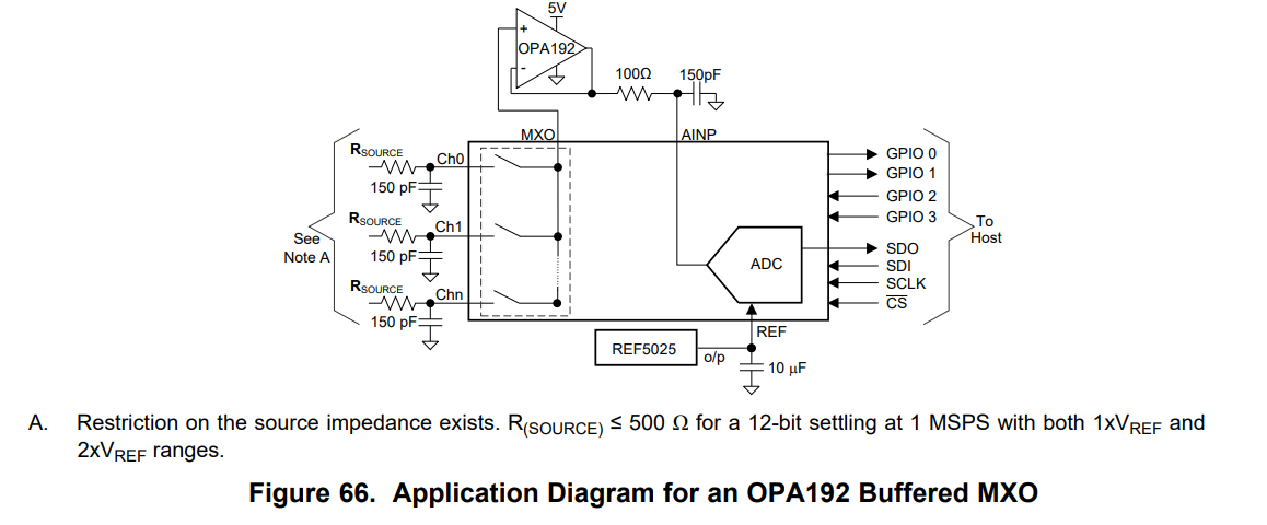

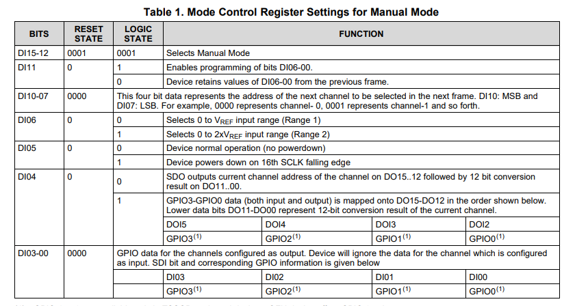

When selecting ADS7953, have below queries:
1) VREF reference is provided externally. According to the specification, the full range range of analog input voltage can be VREF or 2 * VREF. How to choose VREF or 2 * VREF
2) Mxo output signal can be directly connected to AINP pin, or through primary follower and RC filter. How to select these connection modes?
