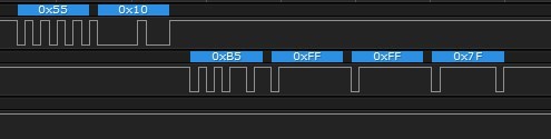

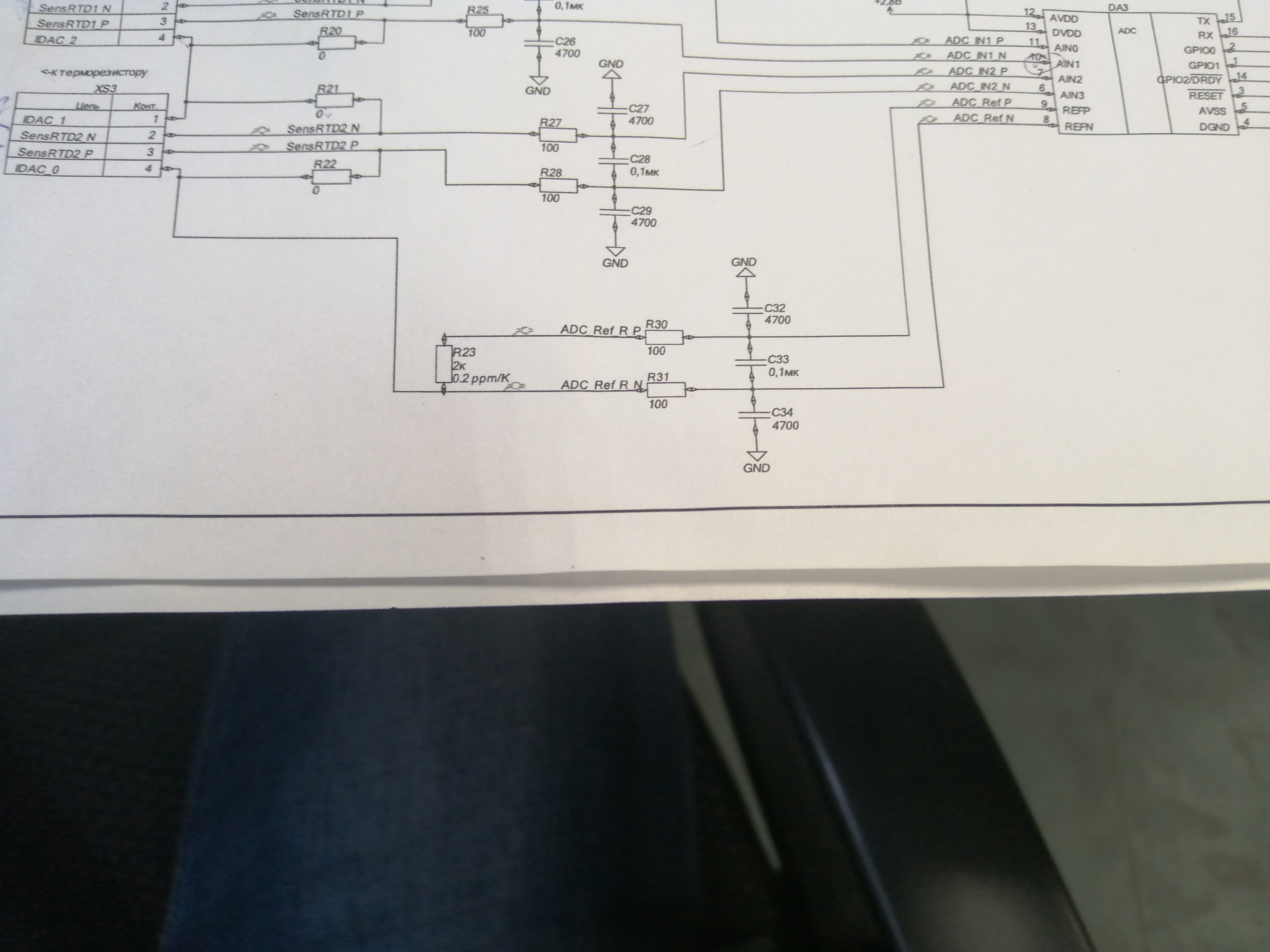

Hello
I have a problem with receiving data from the thermistor. I use IDAC to direct current to the sensor, and ADC`s AIN2/AIN3 inputs to receive data from the the sensor. Gain and IDAC current setting didn`t help. Always get incorrect values.
I use manual mode with counter (without DRDY).

void UART_transmit(void)
    while (!(UCA3IFG & UCTXIFG));
    UCA3TXBUF = 0x55;
    UCA3TXBUF = 0x08;
    while(1)
        UCA3TXBUF = 0x55;
        UCA3TXBUF = 0x10;
        delay_ ();
        while (!(UCA3IFG & UCRXIFG));
        rcv = UCA3RXBUF;
  • Hi user6244799,
    Can you be a little more specific regarding the current path to AVSS for the IDAC current?  Also, what value of thermistor are you using?
    You are getting a positive full-scale reading from the ADC while using the internal reference and gain of 16.  So if your voltage across the thermistor is greater than 128mV you will get a full-scale reading.
    You must also make sure you have a valid current path and that the voltage at AIN3/AIN2 is within the input range of the ADS12U04 at a gain of 16.
    Bob B
