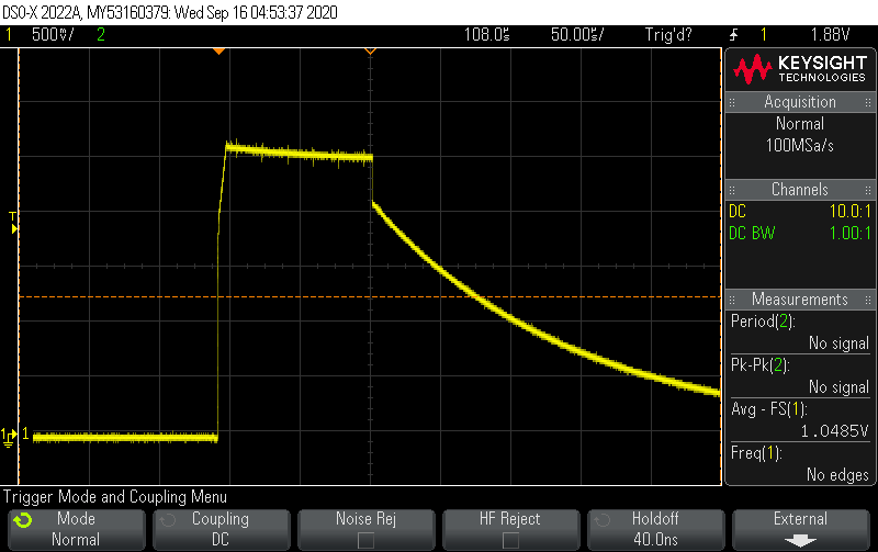

We have noticed that some of our products using the TSC2046 have an unresponsive touchscreen.  This seems to be because the detected coordinates are changing and not stabilized.  I have noticed that on the PCBs that exhibit this symptom, the 2.5 V Vref does not stabilize until 100- 200 uS after the touch was detected.  Some PCBs do not have this issue, and Vref is stable.  The problem follows the PCB (not the touchscreen).  We are not using any external capacitors or filtering on the touchscreen lines.
Why would we see this variability and what can we do to improve the Vref stabilization time?
The 2.5 V Vref on a board with a responsive touchscreen:
Vref on a board showing the slow stabilization:

    The schematic doesn't show anything of concern and looks fine. Looking back at the scope shots provided in the initial post, why is Vref powered for less time in the second image? Could it be Vref is not on when trying to use the touch screen?
    Aaron
  • Thanks for the reply, Aaron.
    The Vref seems to be "on" for as long as the screen is pressed.  So with a longer touch, the scope shows Vref powered on for longer.
    I have done some more testing in the meanwhile, and perhaps it is a small difference in noise levels.  Instead of requiring two consecutive reads to be equal, we are now allowing for two consecutive readings to be within 1 LSB of each other to accept a touch.  With that change, a previously unresponsive touch screen is now very responsive.  Perhaps the criteria for accepting a touch was too stringent, and some of our PCBs are slightly more susceptible to noise than others.  We'll continue testing this change, but I think it may work.
    I still don't know why Vref seems to 'sag', but it seems to still work with a slightly looser touch acceptance criteria.  Maybe our solution is just a work around, but it seems to be ok so far.
