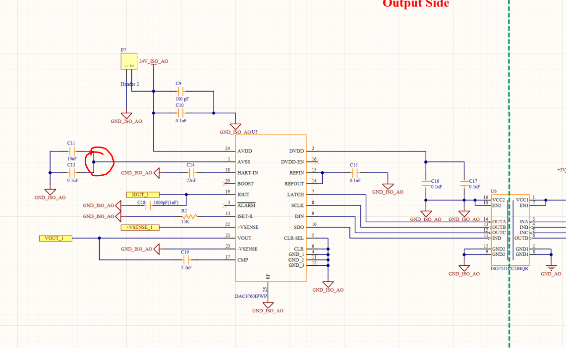

Part Number: DAC8760
We are writing through spi via arduino to DAC Input pins but not able to write anything on that and Output pins are also showing 24V continusly
Design File is attached.

I think the design file attached does not have DAC8760. Please share the schematics.
AK
I am not seeing any issues with the schematics you shared. Whats the power supply sequencing? AVDD comes up first and then +3V3_AO ?
Also since you are using internal DVDD generated supply to power the isolator and DAC, did you verify you are getting DVDD after power up?
Where are you measuring the output voltage, header 2, P5 in schematics?
Can you verify the connections between Vout and Vsense pin is there? Why I am asking to this to verify is the fact that you are getting 24V as output shows the output buffer is rail out.
Last but not least, share the SPI frame, CS/, SDI, and SCLK on the DAC side, not on the isolator side.
AK
Yes, AVDD comes first and then +3V3_AO also we are getting DVDD after power-up.
We are measuring the output voltage at P6, P5 is for current output.
Yes, the connection between Vout and Vsense is there.

After writing the DAC value we tested the voltage on several points on board - At P6, Pin 21 but the value is fluctuating sometimes to 5 V to 1V and then it decreased to 0.5v to 1v itself.
Thanks for checking all the recommendations.
Please do share the SPI frame, CS/, SDI, and SCLK on the DAC side, not on the isolator side.
