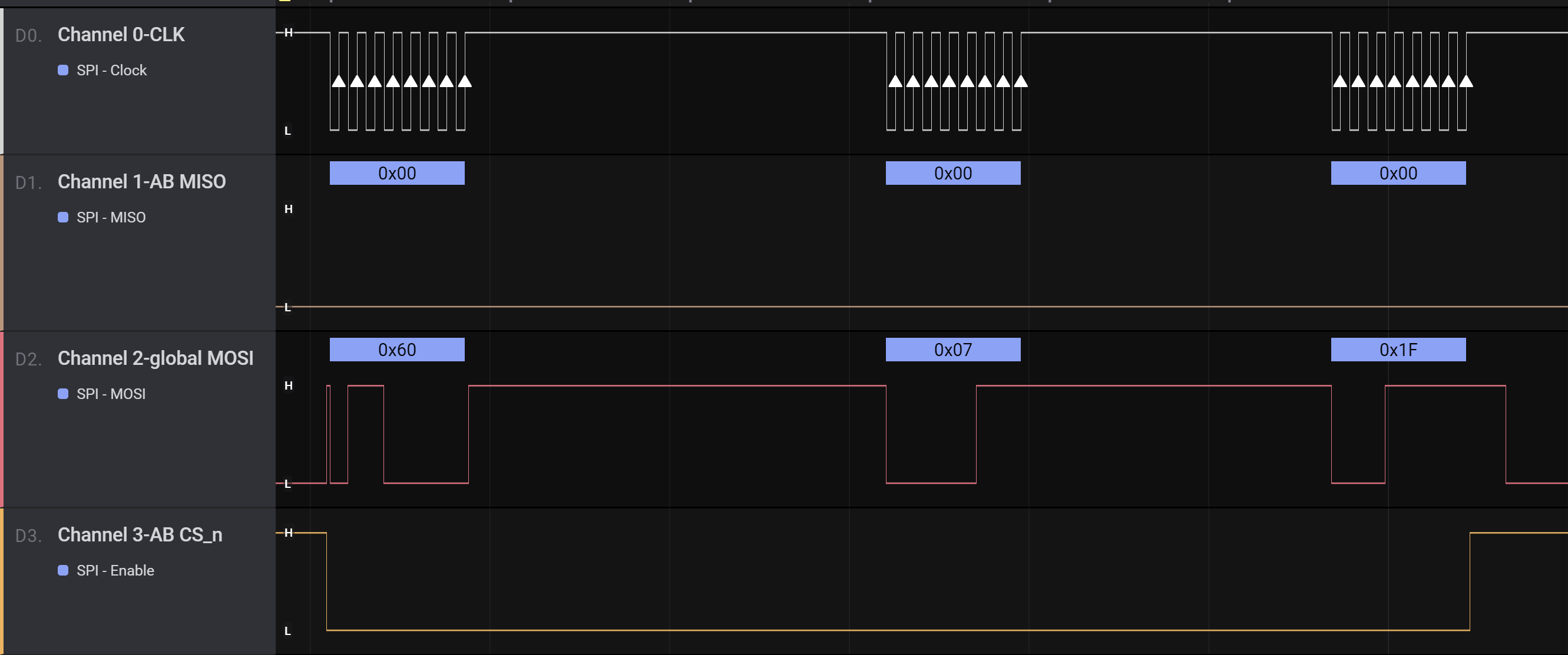

Good afternoon,
We are trying to set our ADC into 3-wire mode but I only see data on the 4th wire. No matter if we write 0x00 0x10 0x01 (3 wire mode) or 0x00 0x10 0x00 (4 wire mode). I see this on multiple ADCs. Do we need to do anything after the 3 wire mode set? Soft reset? something else? Any ideas on why this is not working? We write and read from other registers to confirm ADC SPI functionality, and you can see from the diagrams that the response is on the 4th wire.
1st register write: reset and 3 wire mode
register write: value written 0x1F
register read: reads value of 0x1F on 4th wire
