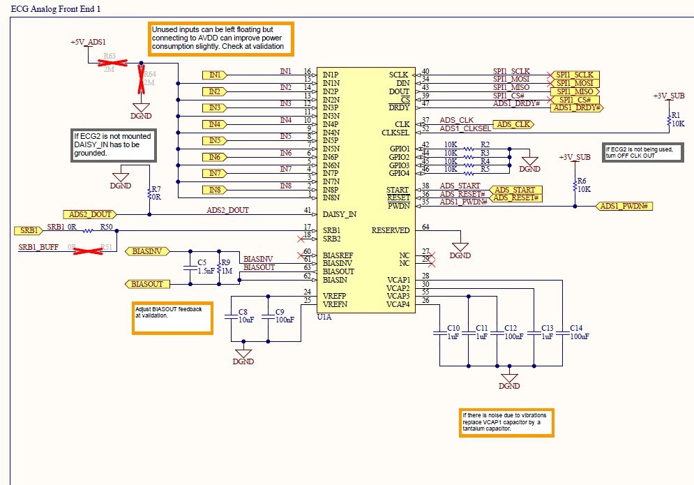

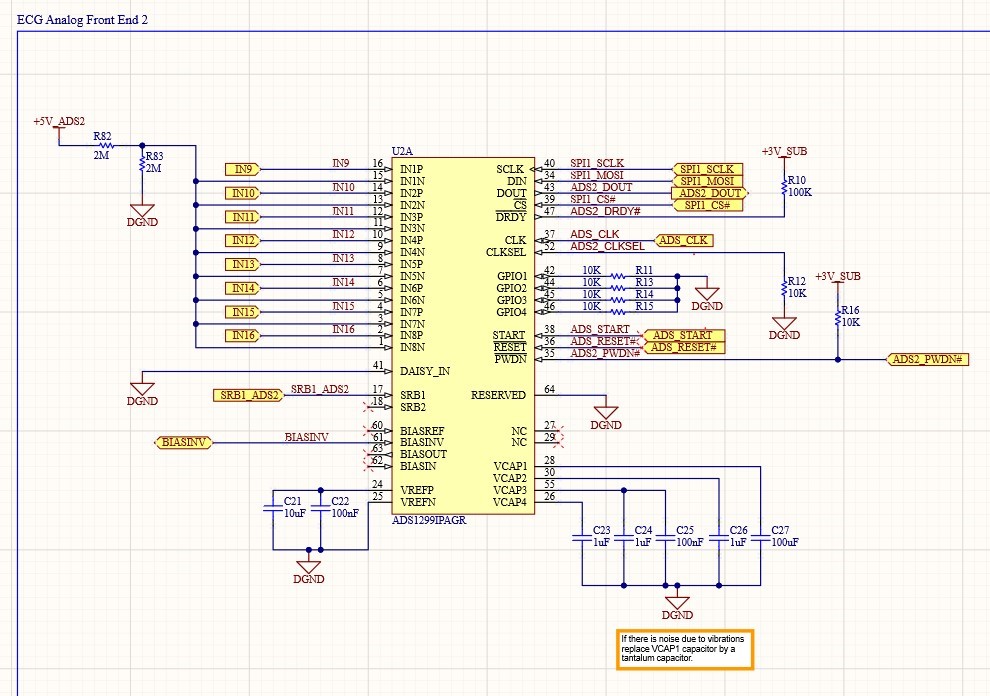

We have implemented a design with two Daisy-chained ADS1299 and are having some issues receiving data from the second IC.
We have correctly validated the 8 channel version, but when trying to talk to the daisy chained 16 channel version, the last 8 channels data is all 0. I have checked power, and all the signals, and everything seems to be fine except that DOUT from the second ADS1299 is always 0. It seems that something is pulling it to low all the time, and no matter in which state we are this signal is 0. I have checked impedance respect ground when not trying to communicate and is not shorted.
The schematics are the following, but we have removed R7 to enable the daisy chain and R82 and R83 are not assembled.

  • Hi Husein,
    From your design schematic, it looks like you are using an internal oscillator from the device U1A to drive the second ADS1299 (U2A). Please make sure that both devices follow the correct power-up sequence as stated in Figure 67 especially for U2A since it using the internal oscillator from U1A. I hope this helps with your debug.
    Thanks.
    -TC

  • Hi Husein,
    From your schematic, you are also sharing the RESET pin for both devices. As you stated, you may have to set the PDWN=1 for both devices during power-up if you are sharing the SPI signals, and using the internal oscillator to drive the second device. It is a little tricky in this case if you cannot issue a RESET pulse to the second device separately from the first device. The second device will not get the CLK output from the first device until you set the CLK_EN bit in the CONFIG1 register. You may have to make sure all the registers in the second device are correct after it is power up and get the CLK signal from the first device.

  • Hi Husein,
    After some discussion, the design team recommends using the daisy-chain configuration shown in Figure 70 (b). For daisy-chain configuration, it is crucial for both devices in the daisy-chain to meet the power-up sequencing described in Sec 11.1 for proper device initialization. If the power-up sequence is not met, then the device may not be operating correctly as what you are seeing. For your design configuration, it will be best to have separate RESET signals so each device can be initialized separately instead of having separate PDWNn signals.

  • Hi Husein,
    The recommended daisy-chain configuration is to clock all the daisy-chain devices with the same external CLK instead of cascading the clock from one daisy-chain device to the next. If the latter case is used, then a separate RESET signal will be the most reliable way to get all the devices in the daisy-chain to initialize properly.
