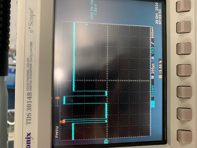

    I tested with an oscilloscope, the registers are not reading back the values I am writing.
    I am not sure if something's wrong with the code, but the write and clock seemed ok in the oscilloscope.
    I have already modified the board and 4 wires are connected at the places of the resistors, so I am trying to avoid using the GUI for now.

    Did as you said. I cant see read back from the DAC chip. We have been discussing only the DAC chip, I am also programming the lmk chip.
    Datasheet says it has 13bits if address, GUI shows only 12bits. I just padded them to zero, seems ok from the datasheet (not 100% sure though).
    Can I send you the code?
    You can send the code. Can you also send a captured timing diagram of the clock, data signals, and the enable. If possible probe as close to the DAC as possible. This will show us if the DAC is receiving the data correctly.
    David
  • I took a video of the oscilloscope response. Originally the "transferDelay" in my code was 2 ms, I increased it to see clearly in oscilloscope.
    Here  yellow = sck
    green = cs
    blue = sdio
    red = sdo
    The sdo wasnt at the same power level I had to adjust to make it bigger and it looks weird.

    Thank you for reply. I tried that. Isnt working. Is the read back value supposed to be like in the video that I sent?
    Is there any other way I can automate the programming? We were actually planning to demonstrate a system with this where we were hoping to make it user friendly and not have to carry a laptop around all the time. Any suggestion would be helpful.
    There does seem to be a problem with your SDO pin. When there is nothing being read the SDO pin should be high. When you are reading back you should see it see the register value on the pin. Below is a capture of a read back from address 0x433, which has a value of 0x403C.
    Also, here is a capture of a write, SDIO pin, to address 0x433, the value being written is 0x403C. You can try this same write and compare it with the capture to verify your program is writing the in the correct format.
    David
  • Hi David
    Seems like my sdo pin always stays low. When you tested in the oscilloscope did you use my code?
    fmj
    When I performed the test on the oscilloscope I used the GUI to perform the writes. This way you can compare it against what the microcontroller is outputting. If you perform the same write as I did above you should see the same outputs from the microcontroller.
    David
