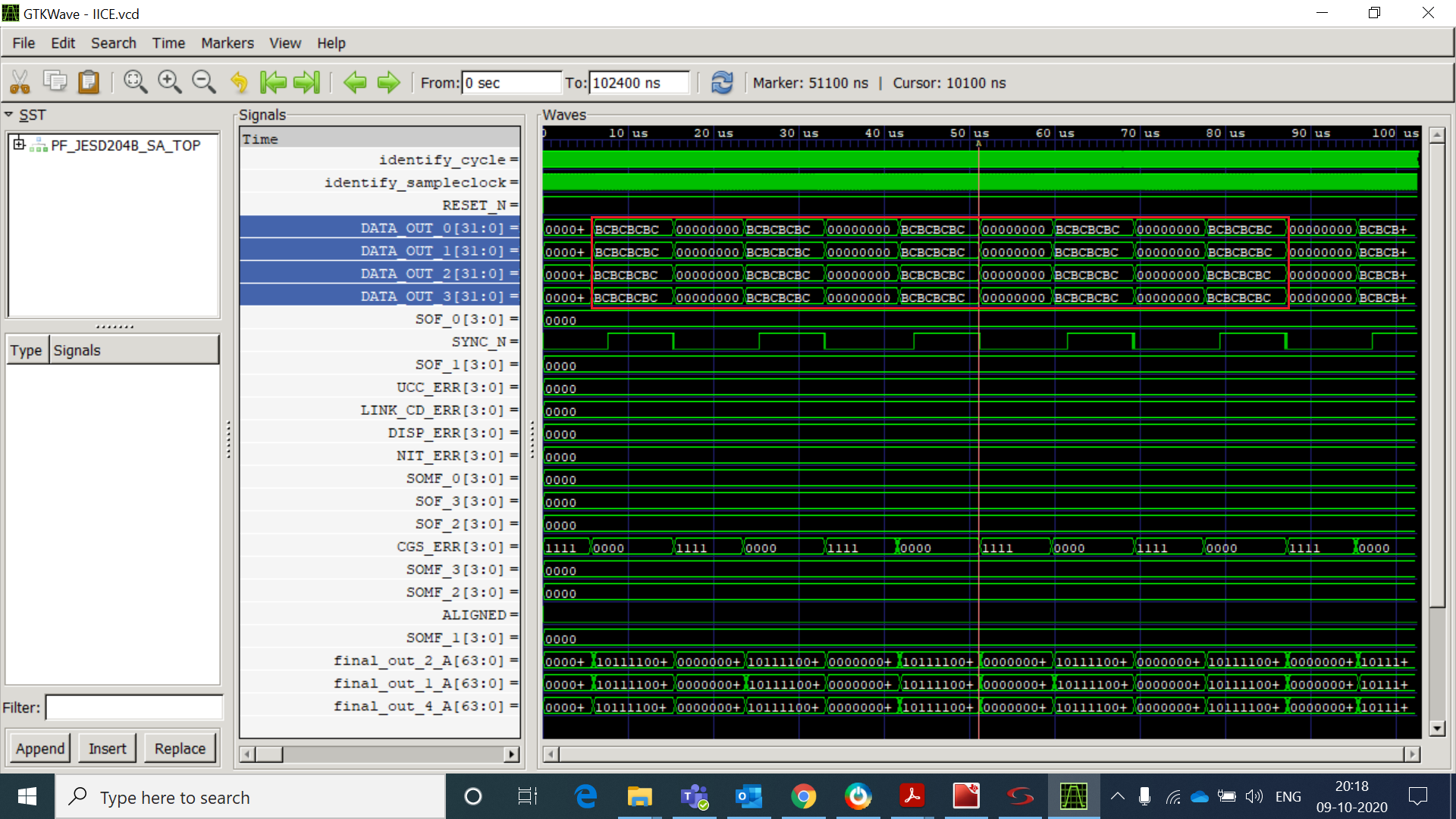

I am using ADC12DJ3200EVM and I have used K28.5 test mode and I am getting below results as shown , Please can you confirm is this expected results for this test?
Hi Deepak,
The results looks as expected. You see a K character which is BC in Hex.
Neeraj
