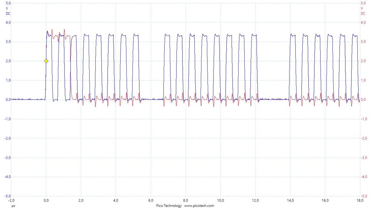

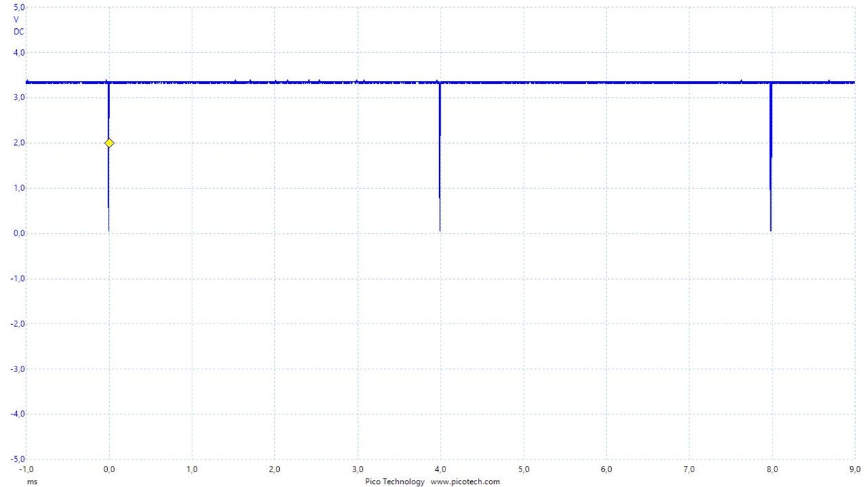

I used a Picoscope oscilloscope to measure the signals. It is capable only to measure 2 channels.
The CS and clock signals:
The DRDY and the CS signals:

I would like to ask your help to solve the measurement read problem. The forum posts about this IC helped me a lot to get to this point, but now I can not find the solution there.

    Of course, I use the RDATAC mode. DRDY signal:

  • Hi Istvan,
    Everything looks correct on your scope plots. All signals are behaving exactly like it is supposed to be for the device. When you are reading the device registers, you have to issue an SDATAC command. If you want to continue with reading data after register read, then you have to issue the RDATAC command to enable conversion data output.
