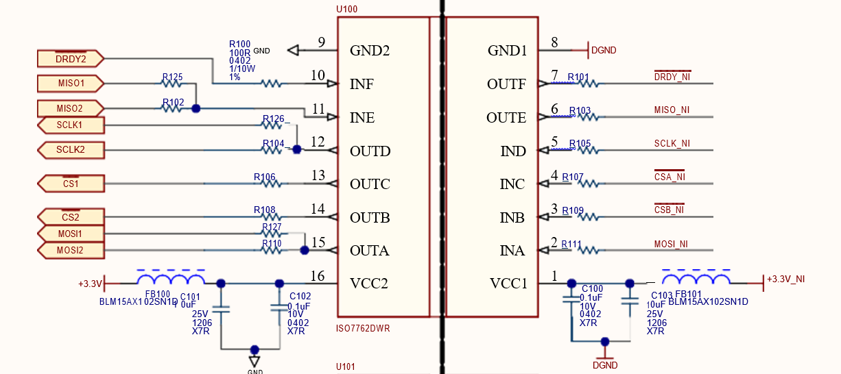

HI. I use two ADS1298 in cascade mode. Can i configure both of them in parallel? Below is my schematic.

Hi Alex,
You can configure both devices in parallel if both receive the same DIN, SCLK signals, and both of the CS pins are selected. However, to read the data from the device, you will need to use the CS1 and CS2 to select which device you want to read since you are sharing the DOUT pins.
