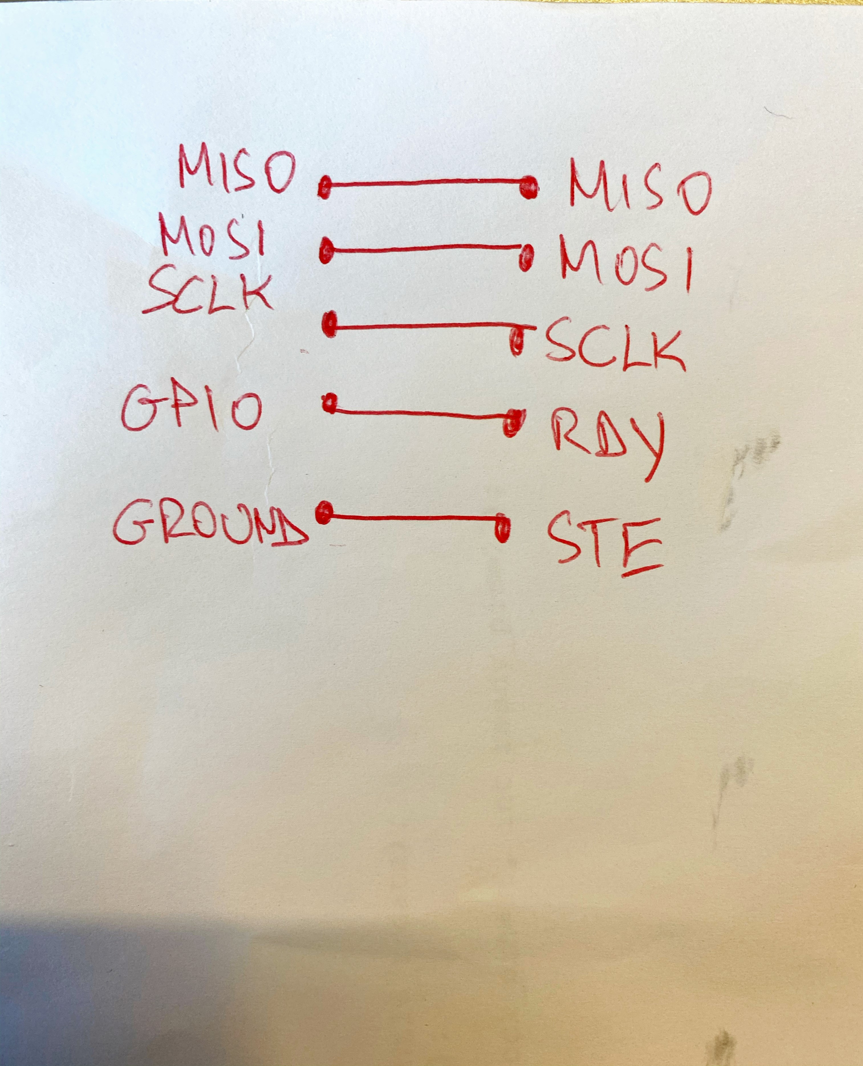

Compiler/AFE4300EVM-PDK: AFE4300EVM-RASPBERRY PI
Part Number: AFE4300EVM-PDK
Good morning, I need help communicating the AFE4300EVM card with the Raspberry pùPi 4. I'm communicating with the card via the SPI protocol. I wrote my own code to read the bioimpedance in python and I'll put my script on it. I also take a picture of you with the links I made. my problem is that from the ADC_DATA_RESULT I always get zero. I kindly ask you if the connections I made are right? and at the code level where it might be the problem that I always get zero. Thank you so much in advance
import sys
import time
import math
import os
import csv
import pigpio
# GPIO settings
CLK_PIN = 4
CLK_FREQ = 100000
RDY_PIN = 16
# Init GPIO
pi = pigpio.pi()
# SPI settings
SPI_FREQ = 100000
mode = 1
spi_handle = None
# Registers
DEVICE_CONTROL1 = 0x09
DEVICE_CONTROL2 = 0x0F
ADC_DATA_RESULT = 0x00
ADC_CONTROL_REGISTER1 = 0x01
ADC_CONTROL_REGISTER2 = 0x10
ISW_MUX = 0x0A
VSENSE_MUX = 0x0B
BCM_DAC_FREQ = 0x0E
MISC_REGISTER1 = 0x02
MISC_REGISTER2 = 0x03
MISC_REGISTER3 = 0x1A
WEIGHT_SCALE_CONTROL = 0x0D
IQ_MODE_ENABLE = 0x0C
def read_device(address):
  packet = []
  packet.append(0x20 | (0x1f & address)) # the lower five bits [20:16] are the real address bits
  packet.append(0x00)
  packet.append(0x00)
  (count, data) = pi.spi_xfer(spi_handle, packet)
  print("SPI Read. Data sent: " + (','.join(format(p, "04X") for p in packet)))
  if count < 3:
    print("Error reading from SPI. Data received: " + str(count) + " bytes: " + (','.join(format(d, "#04X") for d in data)))
  print("SPI Read. Data received: " + str(count) + " bytes: " + (','.join(format(d, "#04X") for d in data)))
  return (0xff00 & (data[1]<<8)) | (0xff & packet[2])

def init_device():
  print("Init device:")
  pi.hardware_clock(CLK_PIN, CLK_FREQ)
  pi.set_mode(RDY_PIN, pigpio.INPUT)
  print("Init SPI\n")
  spi_handle = pi.spi_open(0, SPI_FREQ, mode)
  print("SPI handle: " + str(spi_handle))
  print("Init registers\n")
  write_device(MISC_REGISTER1, 0x0000)
  write_device(MISC_REGISTER2, 0xFFFF);
  write_device(MISC_REGISTER3, 0x00C0);
  write_device(DEVICE_CONTROL1, 0x6006);
  write_device(DEVICE_CONTROL2, 0x0000);
  write_device(ADC_CONTROL_REGISTER1, 0xC1C0);
  write_device(ADC_CONTROL_REGISTER2, 0x0065);
  write_device(BCM_DAC_FREQ, 0x0040);
  write_device(WEIGHT_SCALE_CONTROL, 0x0000);
  write_device(IQ_MODE_ENABLE, 0x0800);
  print("Device initialized\n")
