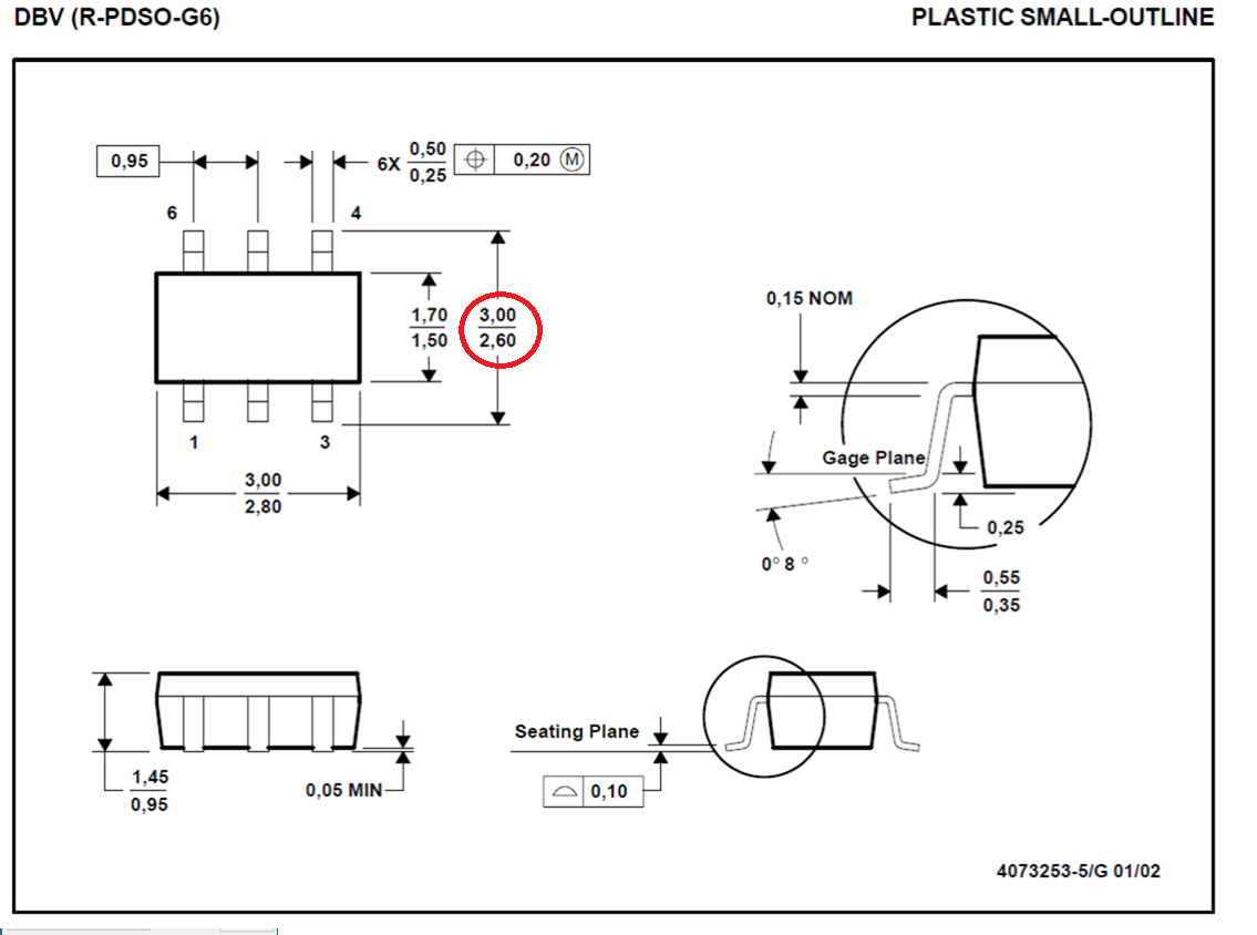

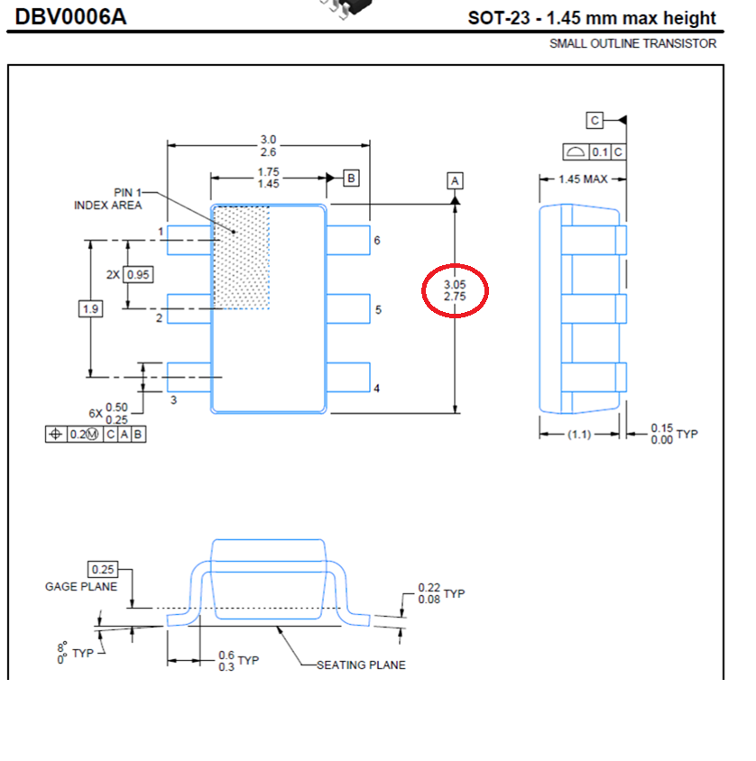

In DAC7512 datasheet, there are 2 package information of SOT23-6 in page16 and Page23 as below.
Which is correct drawing? Your advice would be so appreciated.
Akihisa Tamazaki

This device is our DBV package.
Please proceed with details on page no 23 for PCB land pattern creation.
AK
