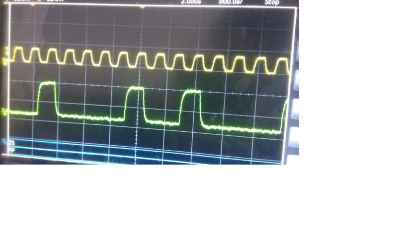

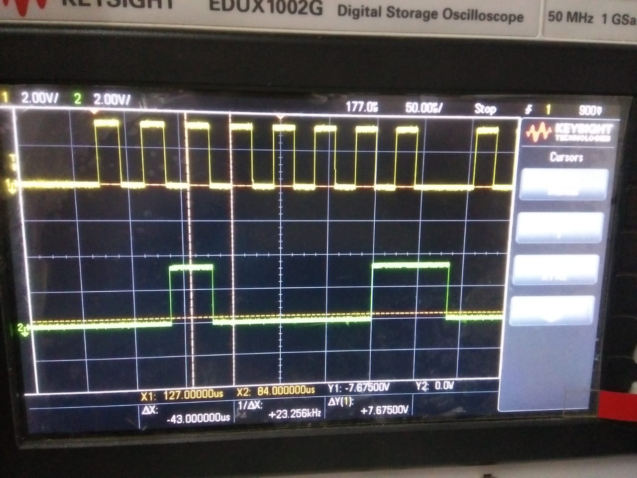

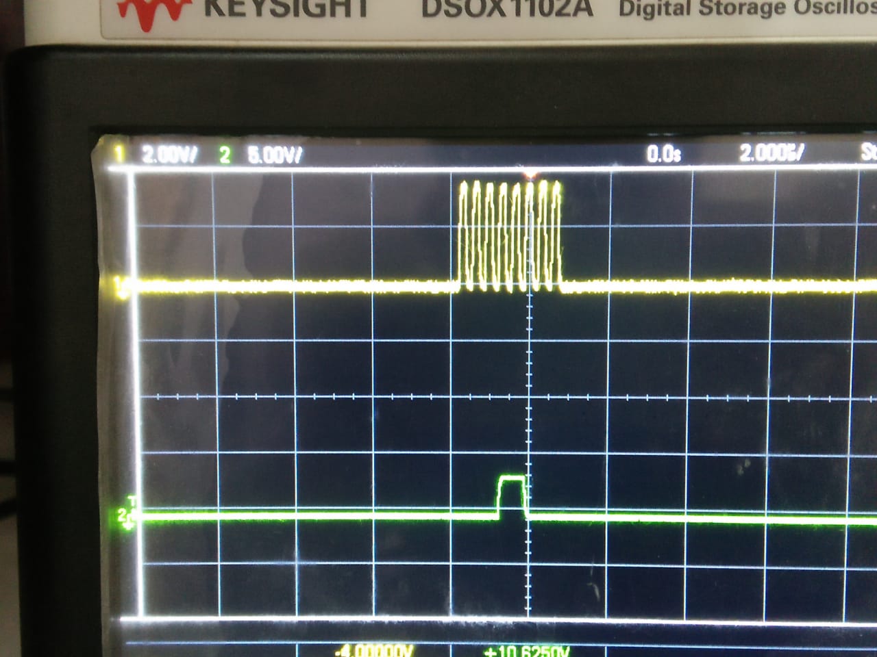

  • Hi Brian
    I am attaching DSO screenshots and the controller and power schematic.
    After sending 0x06 21 00 00 command to read single register I get no output

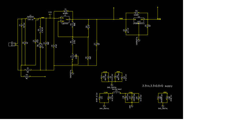

  • Hi Brian

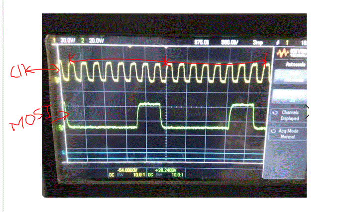

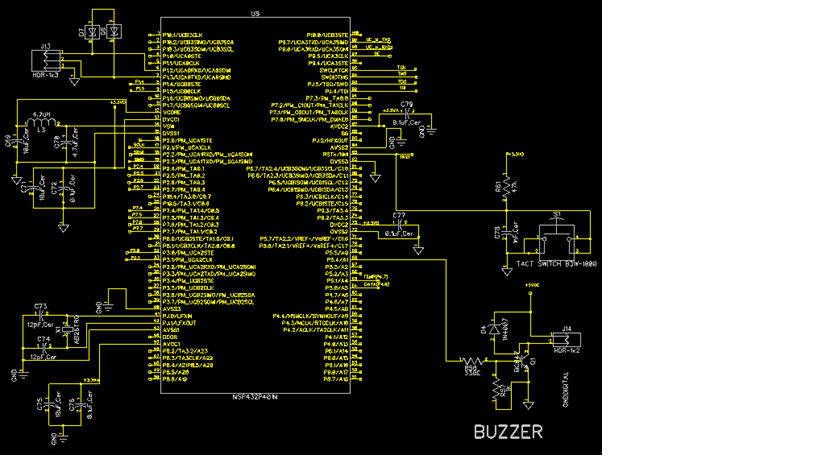

  • Here is the schematic from controller side, it is basically just direct connection between the MSP432 and the ADC. I tried with direct connection and with 47 ohm resistor in series.
    After sending the single read register command in step by step manner I get following on the DSO
    0x06
    0x21
    followed by 0000.
    The expected response is 0x80 which is the default value of the status register but I get nothing

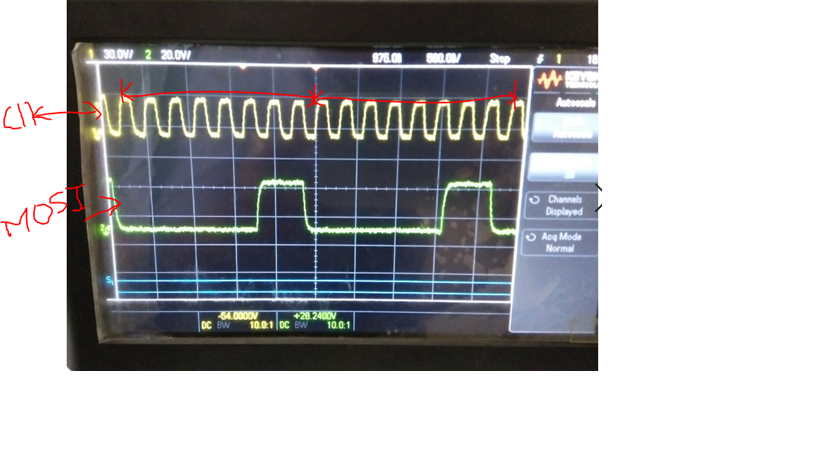

  • Hi Bryan
    Sorry about that. The website was glitchy last time. I am uploading the images again now.
  • Hi Nikhil,
    When I look at the image below, it seems like DIN is transitioning high-to-low/low-to-high when SCLK is transitioning high-to-low i.e SCLK falling edge. However, note that the ADC latches data on DIN on the SCLK falling edge, so if your digital signals are also transitioning during this time, the ADC might not get the command you intended.
    Can you confirm how you are triggering data on DIN (MOSI)?
    -Bryan

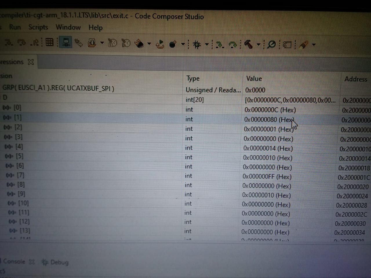

    now I get correct default value of Resistor and I take this value in D[17] array
    D[0]  - 0x0C
    D[0]  - 0x80
    D[0]  - 0x01
    D[0]  - 0x00
    D[0]  - 0x14
    D[0]  - 0x10
    D[0]  - 0x00
    D[0]  - 0xFF
    and so on, now I am tying to write this resistor with some value According to my requirement  but I am not get this value back when I am verifying that value using read command. I am getting  wrong value  for some resistor

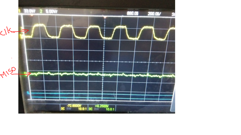

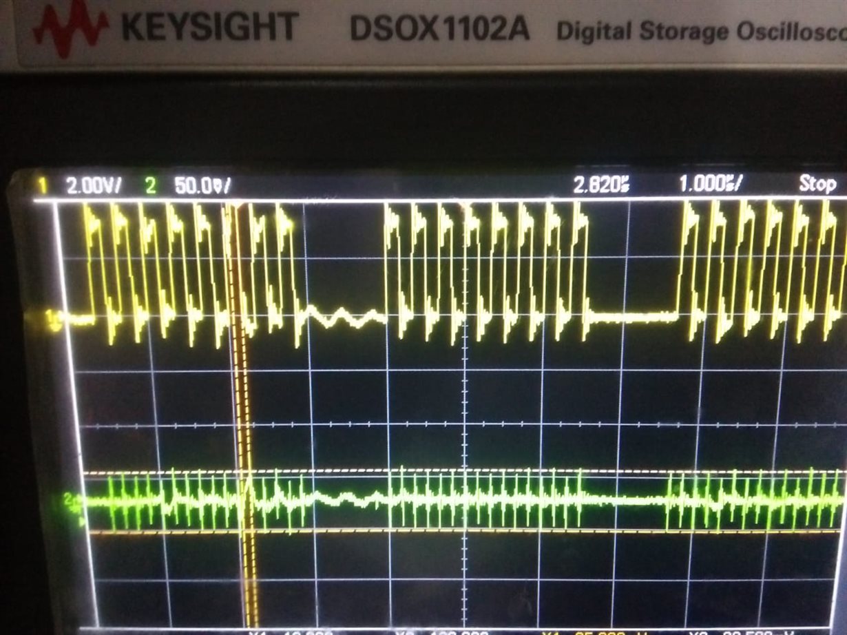

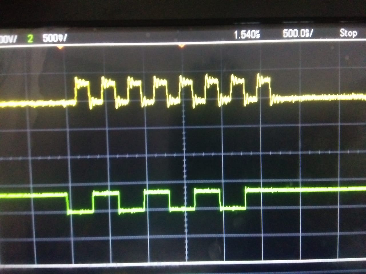

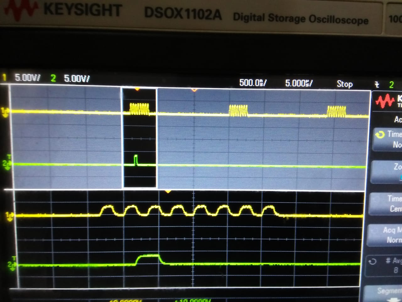

    I am getting the same problem again to read the ADC resistor default value. below program I have written is working fine one day before but now I am not getting the default value of ADC resistor for the same program. I have to attach the DSO screen Shot here, ADC sends 60 mV noise signal back to the controller instead of  correct value.
    Here in Screenshot  -  Channel one is the Clock signal
                                      -  Channel two is SOMI signal
    ADS11s08 default resistor value reading working code

  • Hi Akshata,
    I see from the initial schematic that Nikhil posted that you have two different ground symbols for AVSS and DGND. This implies a split ground plane, which we generally do not recommend. If there are ground potential differences between the analog and digital grounds this could certainly cause communication issues.
    Either way, your digital communication signals are noisy, which usually indicates a grounding or layout issue. In other words, I am not so sure this is a code issue at this point, given the information you have already provided. Here are some general tips about this topic: https://e2e.ti.com/support/data-converters/f/73/t/755516
    -Bryan

    here CCS screenshot for the correct default value of ADC resistor
    DSO screenshot when ADC giving the correct result -
    Channel 1- Clock
    Channel 2 - SOMI   - here is very clear waveform is getting
    here is a  DSO screenshot with ZOOM picture
    when ADC not giving me a result then at SOMI signal we get nothing and at the same time whatever command sent by the microcontroller to ADC for reading ADC resistor is correctly sent to ADC hence we don't
    where is the problem occur?
    One thing I noticed when I verifying that the microcontroller is sending the correct data  to  ADC or not, I was trying to send 0x55 to ADC over the SOMI line then the idle state of the SOMI line is high
    this waveform is capture at the time when the noisy power supply is used
    Channel 1 - Clock
    Channel 2 - SOMI  ( I am sending 0x55 over SOMI to ADC )
    and when I remove this supply I used another power supply then the same SPI  setting idle sate of SOMI is  LOW
    Channel 1- clock
    Channel 2 - SOMI (here again I am sending 0x55 over SOMI to ADC)
    How this difference is coming for the same SPI setting?
    Please suggest what is wrong and provide a solution for these.

    as your suggestion I tried to read single register and observed that clock and DIN is not synchronize as per datasheet of ADS114s08 and I am using  SPI mode one as per datasheet of ADC
    here I am reading status resistor of ADC for am sending RREG command (3 byte Command)
    1st byte    - 0x21
    channel 1 - clock
    channel 2 - MOSI
    here am sending 0x21( 1st byte of command ) binary equivalent is - 0010 0001
     as per datasheet data change occur at raising edge and data latch at falling edge but here data change at falling edge and latch at raising edge but SPI setting is OK as per ADC datasheet    what is reason behind these please suggest the solution to overcome this issue?

  • Hi Akshata,
    Would it be possible to double check the digital interface settings again? You are correct that the ADC latches data on the SCLK falling edge, so if you are showing SCLK and DIN in your scope shots then your command (0x21h) is not being read properly by the ADC.
    -Bryan

  • Hi Akshata,
    Please note that not all MCU datasheets use the same terminology to mean the same thing. In this case, the MSP432P manual uses UCCKPH (phase) and UCCKPL (polarity).
    In the MCU datasheet, table 25-3 says
    • if UCCKPH = 0, then data is changed on the first UCLK edge and captured on the following edge.
    • If UCCKPL = 0, then the clock polarity is low when inactive
    Taken together, the "first UCLK edge" if UCLK idles low is a low to high transition, and the "following edge" is high to low transition. These are the settings you want, since you want to capture data on DIN on the UCLK (SCLK) falling edge, according to section 9.5.1.3 in the ADS114S08 datasheet. Please make sure your settings are correct in your code.
    -Bryan
    I change setting as you suggest and I got the correct value of Resistor and I am able to write and read resistor configuration.
