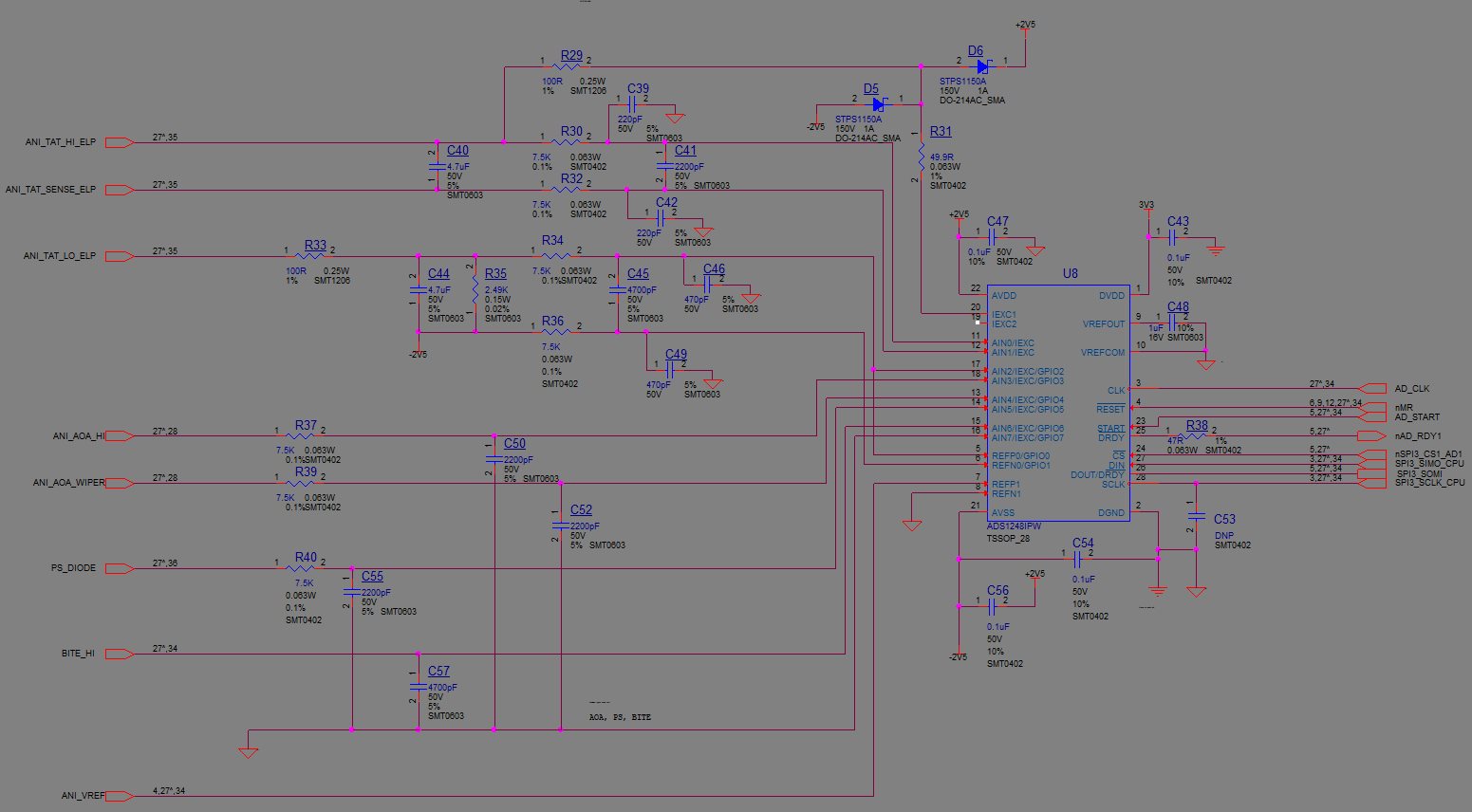

We are using the ADS1248 in our new design and the readings of the line ANI_TAT_HI_ELP (upper left corner of the below schematic)) fluctuate greatly without a clear pattern within the full binary range, and it is always changing so we cannot interpret. Its implementation is shown in the following figure:
We believe that we're performing the correct configuration in its registers by SW, with excitation current=1mA (IMAG=110b), using IEXC1 (I1DIR=1000), selecting the REFP0/REFP1 couple as reference input. However during runtime, the voltage measured over the resistor R31 that is fed by IEXC1 is always 0, which indicates that no current was output from pin #20 of the ADS1248.
For trials, we've already turned the internal reference to always ON (VREFCON=1) or OFF, and we've even removed both diodes (D5 and D6) from the circuit, and the results remain the same (fluctuating).
Anything that we might have left out in its configuration or error in our circuit design?

  • I just want to add that this channel is an interface to a 3-wire RTD-type probe (Total Air Temperature probe), and that all other channels not needing the excitation current were correctly acquired by the A/D.

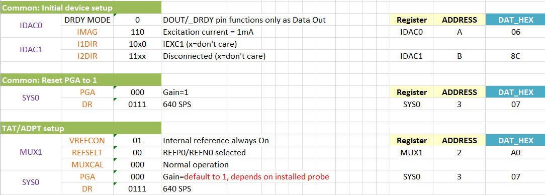

  • Update: We've confirmed that the excitation current is missing from IEXC1 (0.00 A), and below is the configuration to the ADS1248 to output the excitation current on pin IEXC1, just in case one may see something wrong here:
  • Hi Chuck,
    What type of RTD are they using, a Pt100, Pt1000, etc.?
    Why are caps C40 and C44 included in this schematic? I would have thought the filter caps (C39, C41, C42) would be sufficient, but maybe they serve another purpose?
    Can you also explain what is meant by the "results are fluctuating"? Is the voltage across the RTD fluctuating, or are they measuring the IDAC current somewhere (e.g. across R31) and that is fluctuating? What are the results fluctuating between? Can you post some data to review?
    There is nothing obviously wrong with the circuit you have provided, so I will need some more details. Thanks!
    -Bryan

    It has turned out that the excitation current programming by the SW didn't get through to the corresponding register, which explains my problems. Therefore answering to your questions above might not be relevant in this case, instead I would like to explain and to see if you could help.
    Yeah, after taking the same steps in programming the excitation current at the beginning or end of the SW loop control/reading cycles (rather than during initialization), everything looks good, and we've obtained the right level of voltage in every channels (6 in each of the two connected ADS1248). However, I don't know why the steps in achieving such during initialization didn't work out. Below is my initialization sequences, at approximately 1.5s after power-up, so everything should be stable:

  • Hi Chuck,
    Glad you solve the initial problem.
    Can you try to read back the IDAC registers immediately after writing them? So, before the 2x SYNC commands? Let's just make sure the device acknowledges these WREGs
    And you are holding START high during this process correct? You said "active", but I just wanted to confirm.
    You also said you are able to get this to work at the beginning or end of a SW loop, but not at initialization. Is there anything you are doing differently in that loop?
    -Bryan
  • Reading immediately following write to IDAC0 and IDAC1 does work correctly:
    MIBSPI3_RXRAM[10] = IDAC0 = 0x96
    MIBSPI3_RXRAM[11] = IDAC1 = 0x8C
    But again, not with TG1.
