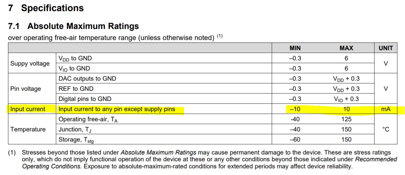

There seems to be some conflicting data in the datasheet. The abs max for current on any pin is stated at +/-10mA.
However, the DAC80508 is spec'ed to deliver 20mA (with a fixed maximum voltage headroom), or 30mA in short-circuit.
The two spec's seem to be in conflict. Would you please provide some clarification?
