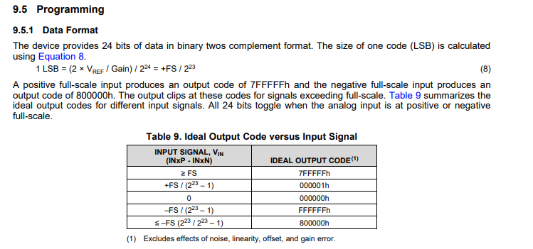

I captured the part of ADS1299 datasheet below;
in here I can see that 0V is ideally 000000h, and maybe +2.048V is 000001h. but i am not sure that -2.5V is FFFFFFh, because FFFFFFh is -2.048V in previous event without changes.
then without any changes, we cannot convert more than -2.048V(-2.4V or -2.5V) because we already use full scale in negative.
then I can think 3 ways to solve this problem.
1. modify the value of V_REFN to -2.5 in source code somewhere, so I can change the scale of negative data format (wider). in this case positive and negative scale factors are little different each other. and the position of 0(zero) is same as before. (000000h)
2. modify the value of 0(zero) state in the source, maybe less than 0(zero), then I can use same scale factors from -2.5V to +2.048V. just 0(zero) is not 000000h in hex code.
3. I don't need to change anything, the system will calculate automatically the scale factor even V_REFP or V_REFN changed.
Please check this issue which one is right, and let me know if there are any misunderstanding. Thanks.

  • Hi Jeong,
    Thank you for your post.
    The analog differential input voltage (VINP - VINN) can span from -VREF/GAIN to VREF/GAIN. When you change the VREF in your design, the LSB of the system also changes, and you need to account for the changes in your source code for data formating (refer to Equation 8 in the datasheet). Your analog full-scale input (FS) now will be 4.548V instead of 4.096V in your previous setup. You can refer to Table 9, which show the ideal output code for different analog full-scale input (FS).
    Thanks.
    -TC

  • Hi Chase,
    The absolute value of the VREFP and VREFN doesn't matter; the ADC VREF will always be VREF = VREFP - VREFN. In your example, your FS now will be equal to 4.5V (FS = VREF  = VREFP - VREFN) when you have VREFP = +2.0V and VREFN = -2.5V. The ideal output code versus input signal (Vin = InxP - InxN) for the ADC listed in Table 9 will still be valid. When the input signal Vin is equal to 0V, your output code will still be 000000h. In addition to the FS, the LSB will change accordingly with the bigger VREF (1 LSB = +FS/2^23 = +4.5V/2^23).
    Please let me know if this clears up your inquiries.
    Thanks.
    -TC
