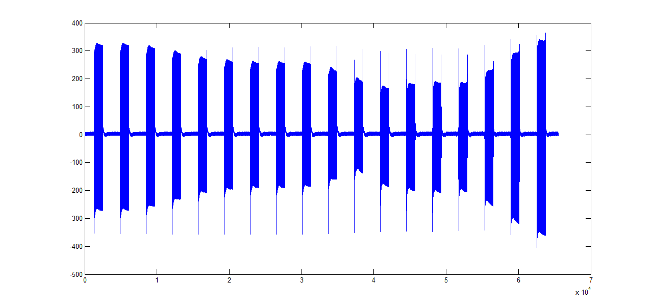

    I am using the ADS5232 to sample pulses. The pulses are being generated by a vector signal generator and generated carrier frequency is 15MHz. In addition I have also included a low pass filter to suppress the harmonics coming out of the VSG (also checked on a spectrum analzer).
The ADC is being clocked at 60MHz and the input is transformer coupled.
The question is the strange pulse envelope which varies from pulse to pulse and difference in the amplitudes.
The first (this one) is a 10us pulse train with 90us off time
this one is a 50us pulse
The above one is a 150us pulse and the below one as well:
I verified the pulse durations and the frequency (using FFT) and everything seems alright except the strange envelopes and the amplitude fluctuations.

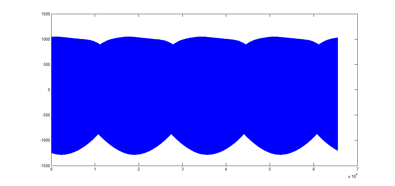

    To further investigate, we captured a single tone with the original clock source and got the following (some sort of amplitude variation over time)

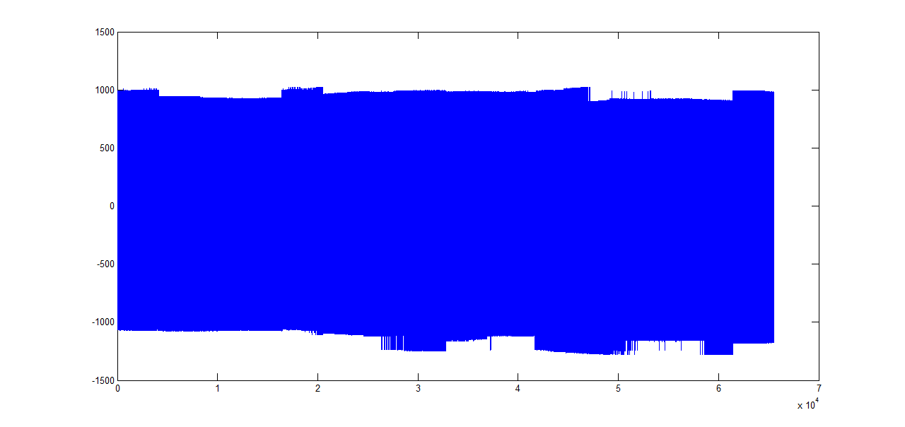

    With the new clock source, the following waveform was observed:

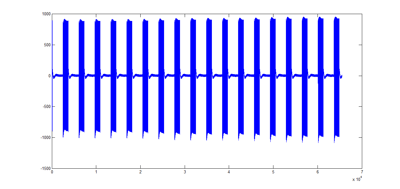

  • Hi Jim,
          I think we made some progress. There are two ADC ICs on the board and we turned OFF the clock to one of the ADCs and the output looks much cleaner now.
    This is the capture of 20us pulses:
    This is the capture of a 150us pulse:
    There is a question here: why is the shape at the starting and after ending of the pulse like the way it is? Again, the pulse does not show this behaviour (when captured using a vector signal analyzer).

    We are trying out sampling inputs signals at two IFs; they are 15MHz and 75MHz.
    The following is the data sampled 60MSps:
    15MHz IF, CW (can seem some amplitude taper)
    15MHz IF, 20us pulses (some amplitude taper can be noticed)
    75MHz CW:
    75MHz IF, 20us pulses:
    Please advise. (raw data files are attached), We initially that this might be because of sub-sampling but we generated the "same" signal in Matlab and it does exhibit this behaviour.
    Also, you will notice the dc-offset during the pulse (when there is no pulse the dc-offset is very little).
