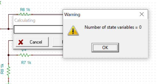

Hi team,
When using TINA-TI to run the attachment 1 file, analysis -- > steady state solver will cause a screenshot warning. What is the reason?
However, some files are normal, such as attachment 2

Hi Amy,
Steady State Solver is a part of switching mode power supply analysis tool function. The state variable is a minimum set of variables that given their values at initial state when t=0 and the system inputs as a function of time can be used to predict system performance when t>0. The dynamic models that consist of coupled first-order differential equations are prescribed to be in state-variables, such as states of capacitors and inductors in combination with resistors in a steady state.
If you add a capacitor or an inductor in the op amp circuit, the state variable message = 0 will not be prompted. But I am not sure that purpose of op amp simulation under the analysis tool. You could just use Analysis --> transient to get your simulation result.
If you have another questions, please let us know.
