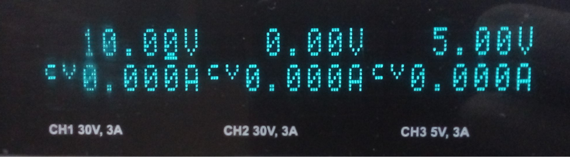

    Can you let me know the supply currents on VCC, VDD?

  • Hello AK,
    I dont think the current drawn is in the measurement range of my Power supply. It is definitely less than 1mA. I have attached an image of the front panel for your reference.
    Seems like device is still in power down mode.
