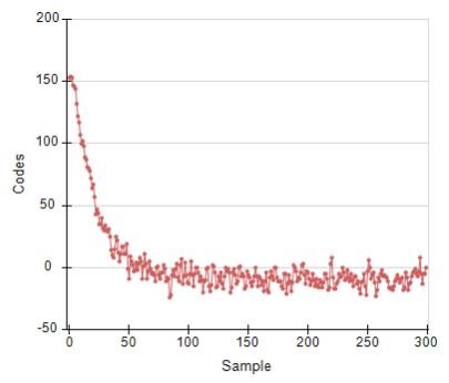

Bizarre question, but I'm new to this part: I'm evaluating the ADS1261 for use in a weigh scale application using the ADS1261EVM talking to a microcontroller (I disabled the EVM onboard micro).  I'm configuring for AC excitation driving four load cells in a bridge configuration, using the bridge excitation signals as the ADC references, taking data at 60 samples/second, Sinc3 filter, PGA gain of 128.  Because this needs to be a low-power application, I'm waking the ADC1261, taking 50-100 measurements in continuous mode, then putting the ADS1261 back to sleep for a while (I've done this both using the PWDN pin and writing bit 7 of the MODE3 register without seeing a difference in behavior).  The problem I'm seeing is that in the data I collect, the first sample is ~200 ADC counts too high, with each successive sample decreasing until values stabilize after about 25-30 samples are collected.  So for a temporary workaround, I have my software taking 80 data points and throwing away the first 30 so that I'm left with 50 good values.  Obviously, I don't want to do this.  Is there something I'm missing here?  I've been through the datasheet and can't find anything obvious about things needing a certain amount of time to stabilize, since I'm not using the internal reference.  Does the Sinc filter need to precharge with data before its output is good?
  • Point to add: This is only being seen when I sleep/wake the ADS1261 with PWDN or the MODE3 register.  If I leave the ADS1261 powered-up all the time, the data collected is good from sample #1.

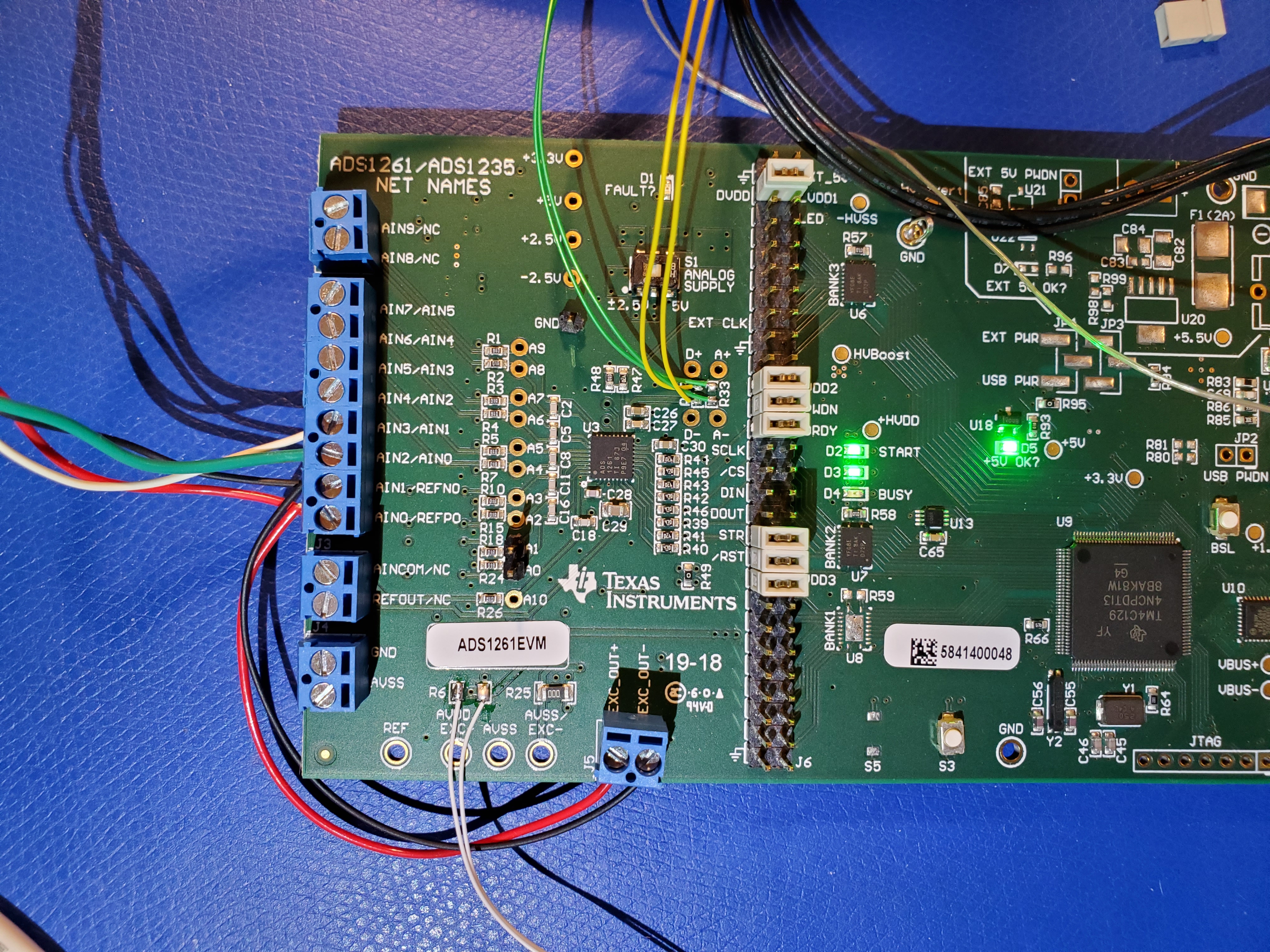

  • I'm using the onboard "AC Excitation" circuit as is.  EXC_OUT+/- are connected to REFP0/REFN0 respectively as well as the +/- excitation of the load cell bridge.  Bridge +/- outputs are connected to AIN0/AIN1.
    Note R6 has been removed so I could measure current, but there's a jumper across it in this setup.  I can demonstrate the issue using the TI Delta-Sigma evaluation software.  Run this script to configure the ADC1261:

    Open the analysis engine window and you should see good data.  Go to the "device" tab in the ADC eval software and manually set MODE3 bit 7 (PWDN) to "software power down" and write the register to put the ADS1261 into power-down mode.  Then go back to the analysis engine window and click "collect data" (300 points will be sufficient); this appears to bring the ADS1261 out of power-down mode before taking data.  When it's done you should see something like this:

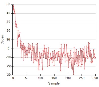

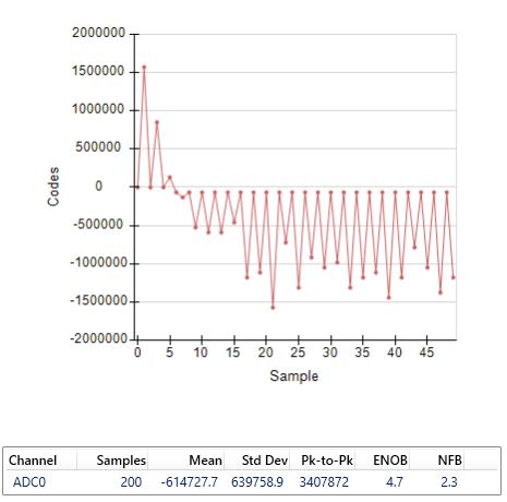

    I've also seen other weird outcomes like these:
    FYI the load cell bridge is constructed of four Galoce GML624's connected as a bridge using a SparkFun BOB-13878 "combinator" board.  The four "combinated" bridge wires are connected to the ADS1261EVM.

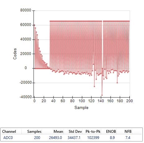

    I would then check to see if the voltage is swapping appropriately from the EXC pins. The last two plots you show where there are wild swings from one input to the next suggest to me that the supply voltages to the bridge are not being applied correctly.
    Let me know what you discover.
    -Bryan
  • I'm going to say ignore the last two plots above.  It appears that doing what I suggested (setting MODE3 PWDN bit true then clicking "collect data" in the analysis engine window) sometimes results in MODE3 getting set to zero, which disables the AIN4/5 outputs that are used on the EVM to do the AC bridge drive.  This appears to be an artifact of the eval software sequence I was trying to use to demonstrate the problem for you.  Forget about that.

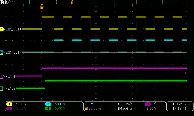

    There's a "DELAY 0" in the script immediately after "HOLDPWDN 1" that allows you to vary the delay time after power-up before starting data collection.  With 0ms delay, I get this:

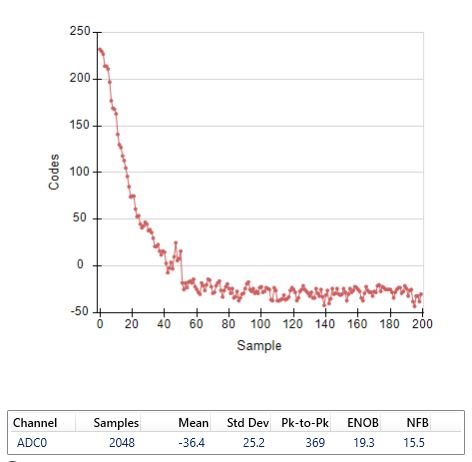

    With 1 second delay after taking PWDN high ("DELAY 1000"), I get this:

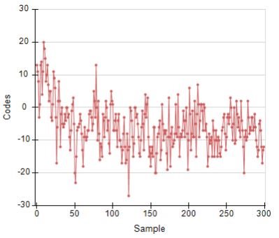

    With 2 seconds delay after taking PWDN high ("DELAY 2000") I get this (just about good):
    It appears that the EXC_OUT+/- on the EVM that I'm using to drive the bridge are coming up right away, certainly not taking 2 seconds or more to get going:
    I must say that if I don't try to power down/up the ADC (or after 2 seconds have elapsed after power up), the data I'm getting looks very good.  I can place various weights on the load cell platform and the data values I get are very close to what I expect (especially since I'm not calibrating yet).
    I'll also add that this only appears when using AC excitation (4-wire AC excitation, as needs to be used with the EVM).

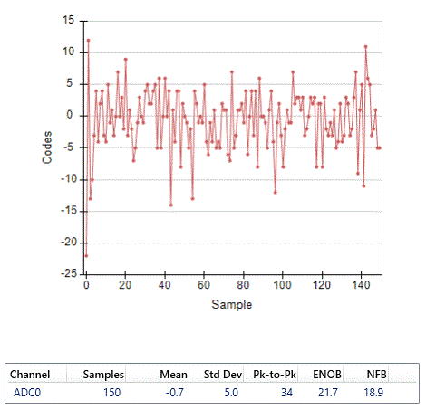

    I tried replicating your setup using my ADS1261EVM. Unfortunately I do not have a bridge to test, so it will not be identical to your results. But I was able to run your configuration and powerdown scripts. As you can see from the results shown below where DELAY = 0ms, I did not get the same drifting data that you did. I ran this test multiple times and did not see any meaningful difference.
    Is there any way the sensor could be loading the input to cause this slight deviation in codes? Have you modified the board in any other way other than what is shown in the images you have already sent?
    Also, it looks like in your script you are performing the system offset calibration (SYOCAL), which requires you to manually short the inputs to the ADC (or more likely the terminal blocks) to remove system offset. You probably don't need to do this since you are running the AC excitation, which is designed to remove the system offset continually. I don't think this is the source of the issue you are describing, but something to consider.
