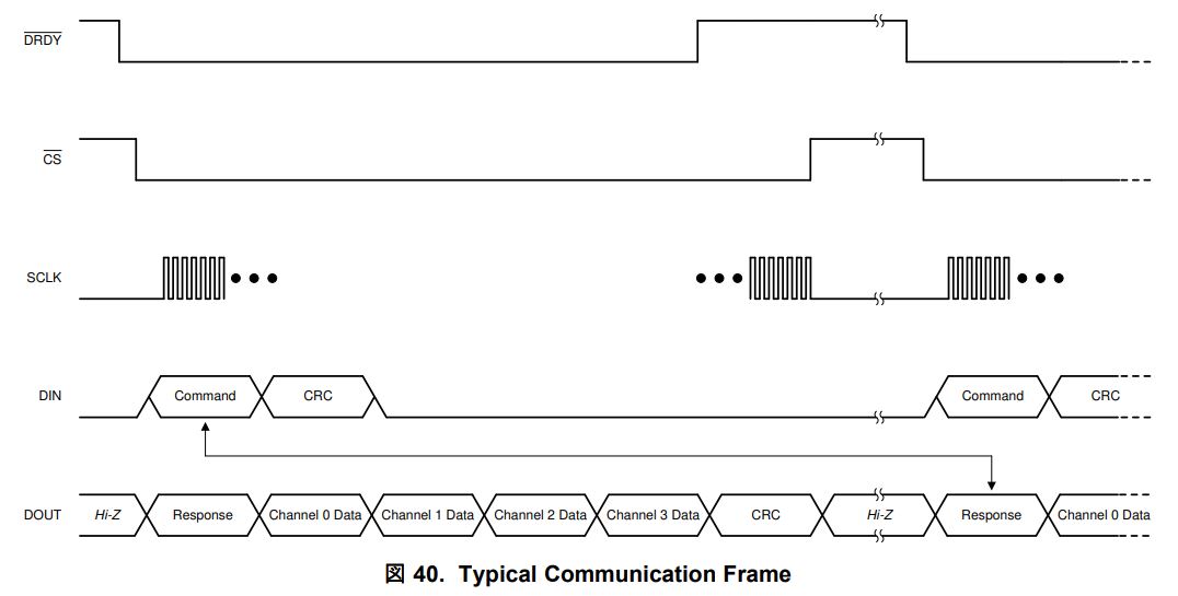

Hello team,
My customer is evaluating the ADS131M04 with EVM.
They have a question for communication frame of the ADS131M04. Are the below data lengths correct?
Response=16bit, Channel 0 Data=24bit, Channel 1 Data=24bit, Channel 2 Data=24bit, Channel 3 Data=24bit, CRC=16bit
->Total: 128bit
*Settings: Host -> Command: Null, Status -> WLENGTH: 24Bit
From the their evaluation result, 144bit of SCLK was sent. What is the reason for the deference between 128bit and 144bit?
Shotaro
  • Hi Shotaro-san,
    all words within a frame do actually have the same bit length. That means if the word length in the WLENGTH[1:0] bit field is configured for 24 bit, then every word will be 24 bit. This gets you to 6x 24 bit = 144 bit.
    The RESPONSE and CRC words are MSB aligned and zero-padded to get you to a 24-bit word as described in the 'SPI Communication Words' section in the datasheet.
