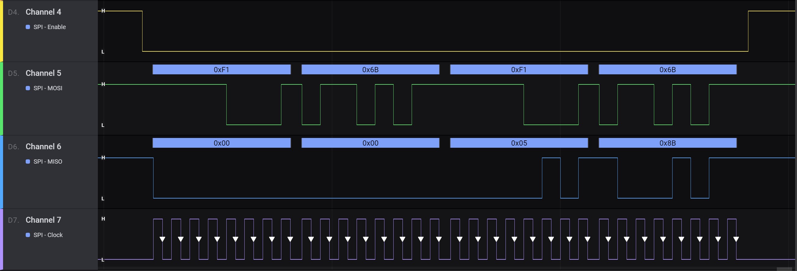

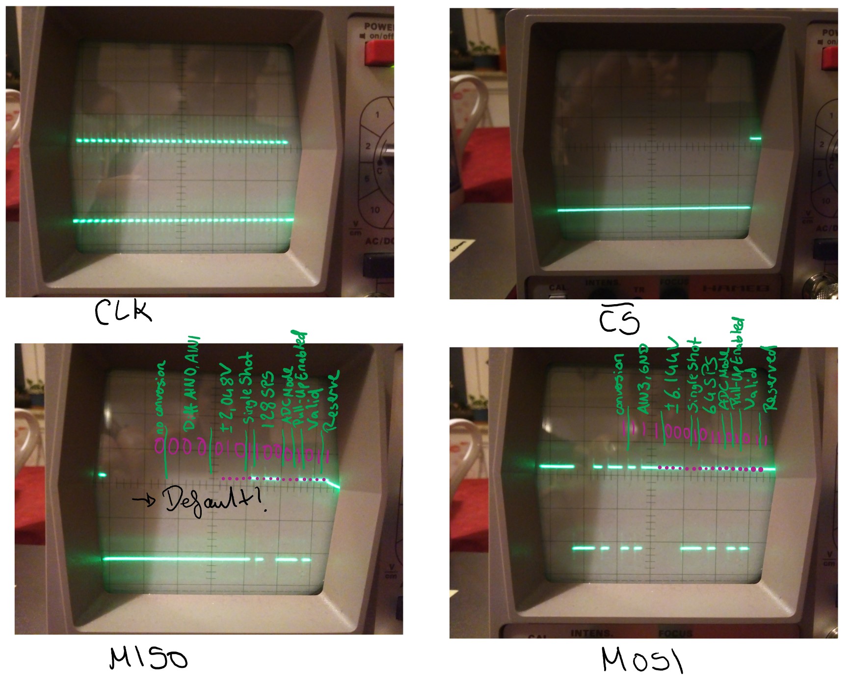

- The Arduino sends the wanted Config Register on the MOSI-wire. The signal was checked both with Logic Analyser and scope and also bit for bit compared to the data sheet. With the scope I also checked the signal on the ADC pin itself, so I am sure that the signal actually reaches the ADS1118 and there are no problems with the wiring.
- The MISO-Pin sends the value "0" as well as the current register used by the ADC. You can see that it is the default config as described in the data sheet, which for me means that the chip is working, but for some reason not updating its config register. Unfortunately, in this mode I can't check either, if the conversion itself would work (no point there anyways if the communication doesn't work, just, you know, straws...)
- Soldering mistakes are highly unlikely, I checked all the connections and they're just as they should be. I also ruled out that the chip was dmaged during soldering, for once the process itself was very quick and also I'd expect the chip to not work at all in this case.
- The clock polarity and phase setup were verified both in the code and via measurement with the scope and logic analyser.
Logic Analyser Output:
Scope:

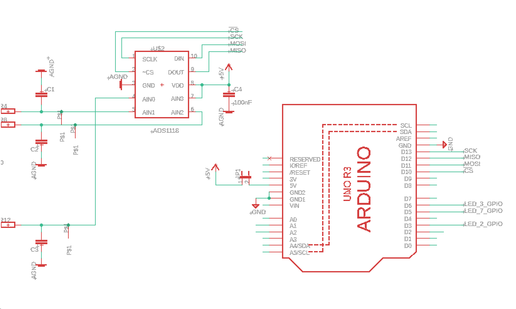

  • Hi Bryan,
    thanks for your reply. This is the schematic:
    Could the problem be, that I'm using Analog ground for the ADS1118? It's connected to my digital ground plane on the board, but not close to the Arduino/ADS compilation.

  • Hi Nina,
    Thanks for the schematic.
    Indeed if there is not a good ground connection between the two boards this could cause communication issues. Is this a single board, or multiple boards with flywiring between them? If a single board, how and where is AGND connected to GND?
