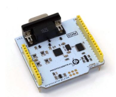

I use board with afe4490  (its arduino shild):
I want to make the most accurate calculation for SpO2.

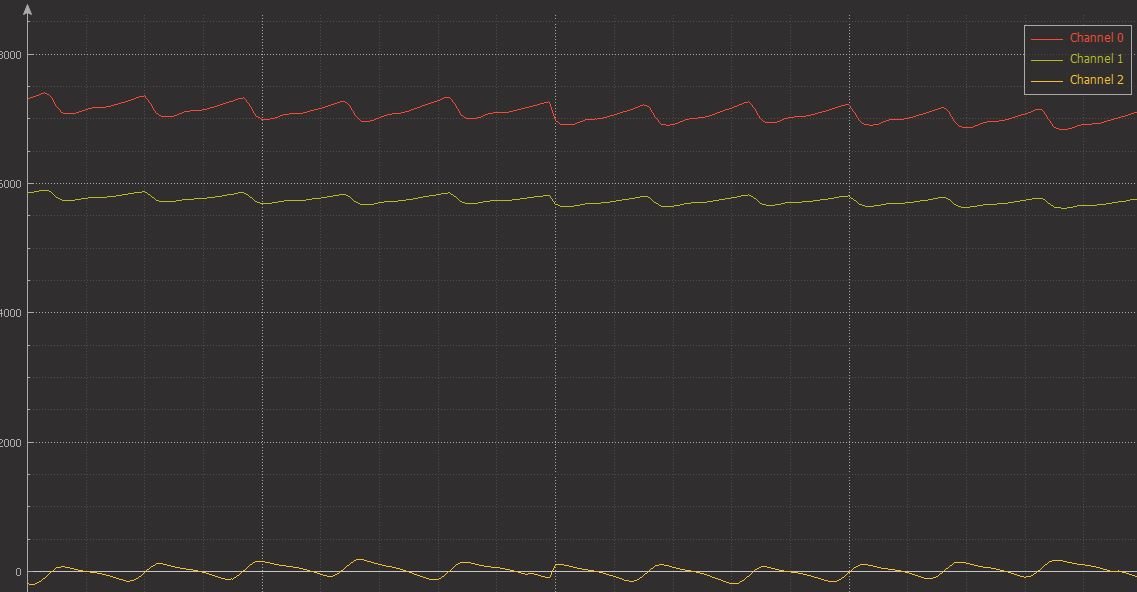

I measured the signals and displayed them on the plotter:
channel 0 (RED)
channel 1 (IR)
channel 2 (inverted and removed DC offset of IR)
