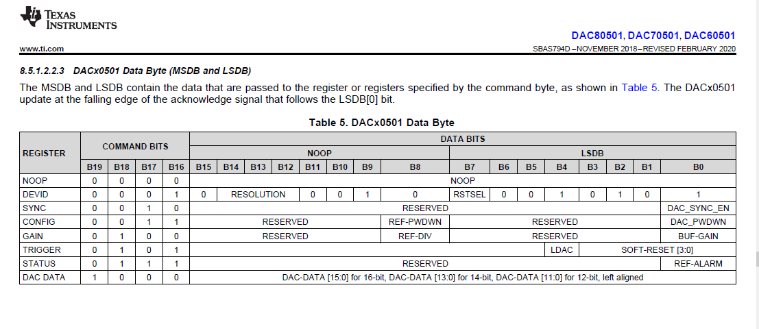

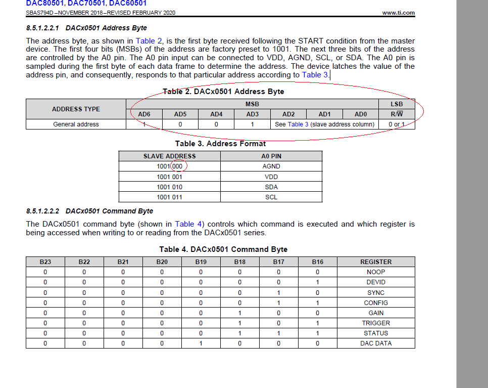

Hello everyone

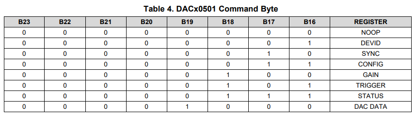

I want to create the code for the DAC80501 but it is not clear to me the data package I have to send.
I seem to have understood that the data packet is 24bit total but I still can't get the information together.
The andress bytes are 8bit but then talk about command bits which are 4 and make 12.
Where do I put the other 16bit?
thanks a lot
ms
  • Massimo,

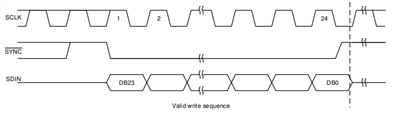

    I'll admit that the datasheet is a little confusing. It was written to show the communication for both I2C and SPI with the data and command structure.
    If you're using SPI communications, you do not use the addresses for Table 2. The section for the DACx0501 Address Byte (described in 8.5.1.2.2.1) is used for the I2C address. To communicate with the DACx0501, you use the /SYNC pin similar to a chip select pin.
    Using SPI communications, you only need the 24 bit transfer for a valid write sequence taken from Figure 58:
    After that, you use the command byte for the first 8 bits of the 24 bit transfer, as you see in Table 4:
    And then you follow that with the data bytes from Table 5 (note that B19-B16 from the command byte are shown in the table below):
    The bits from Table 4 and Table 5 total 24 bits and that aligns with the 24 bits that you see in the valid write you see in Figure 58.
    If you use I2C communication, you need to use the I2C address from the values in Table 2. Then you follow the I2C communication byte by byte. First you send the command byte, then the MSB data byte, then the LSB data byte.

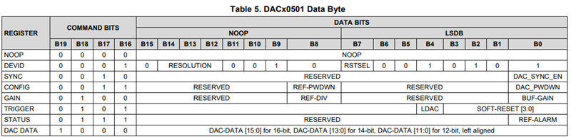

  • thanks a lot
    now I just have to figure out how to set the first 8bit.
    I think I understand that the first 4 are zero and the other 4 are options.
    Would you be kind enough to give me an example of the first byte with a 0 to 5 Volt 16bit SPI configuration?
    Thanks again
    ms
  • Massimo,
    You are correct that the first four bits then become zero. As an example, if you want to set the output DAC to half scale you would write 8000h to the DAC DATA register. To access the register, you send 08h for the command bits. For the sequence, you would send 08 80 00 for the 24-bit transfer.
    The data lines would look like this:
    For this mode of SPI, the /SYNC acts as the chip select, and data is clocked into the device on the falling edge of SCLK.
    Joseph Wu
  • Very nice
    Thank you so much now I try.
    In the datasheet, such an example with SPI written would help a lot.
    ms

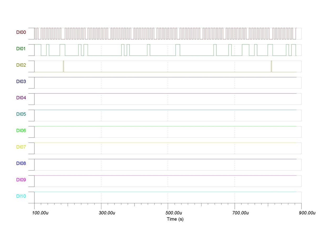

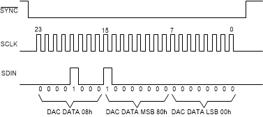

  • Hi, before asking for help again I did some tests.
    I prepared the 3 bytes 0x08h 80h and 00h then I altered the last bits to read any voltage on the DAC output.
    I have no tension.
    I wondered that there are two other 3byte groups to configure the DAC.
    With the data sheet table I built this set of 9 bytes that I found on the net.
    I haven't solved anything.
    On the oscilloscope it looks correct.
    Where am I wrong?
    Thanks so much for the replies
    ms
    CS,SCL,SDIN
    1) 0x05 00 0A // Soft-ResetDelay 200ms
    2) 0x04 01 00 // RefDiv 2, Gain 1 -> 1.25V max. Output
    3) 0x08 43 21 // some DAC code, ~ 328mV
  • Massimo,
    I don't see anything wrong with the communications that you've chosen to send to the device. The commands should set the device as described. I assume that you're using the device in the default asynchronous mode?
    For your scope shots, it would be easier to see them all on a four channel scope, so you can see the /SYNC, SCLK and SDIN on the same screen and see that the signals are aligned and the timing is correct. Go to the datasheet and check the that all the timing matches that listed. Verify the SCLK frequency, and that the data is not changing on the falling edge of SCLK.
    You can also zoom in with the oscilloscope and check that all the digital lines are clean, without other glitches in the signal.
    Can you provide a schematic to the board to show all the connections to the device? I would verify that all the connections to the device are correct. Check that the digital lines are all going to the proper pins, and that they are being received at the device pin. I would also check the reference voltage, supplies, and ground are all connected from the microcontroller to the device. I would also make sure that the microcontroller device and the DAC have the same supply. If the microcontroller is running at 3.3V and the DAC is running at 5V, then the digital output high may not be high enough in voltage to be received as a high. If this is the case you may need to run the device at a lower voltage, or add in a level translator for the communication.
    Joseph Wu

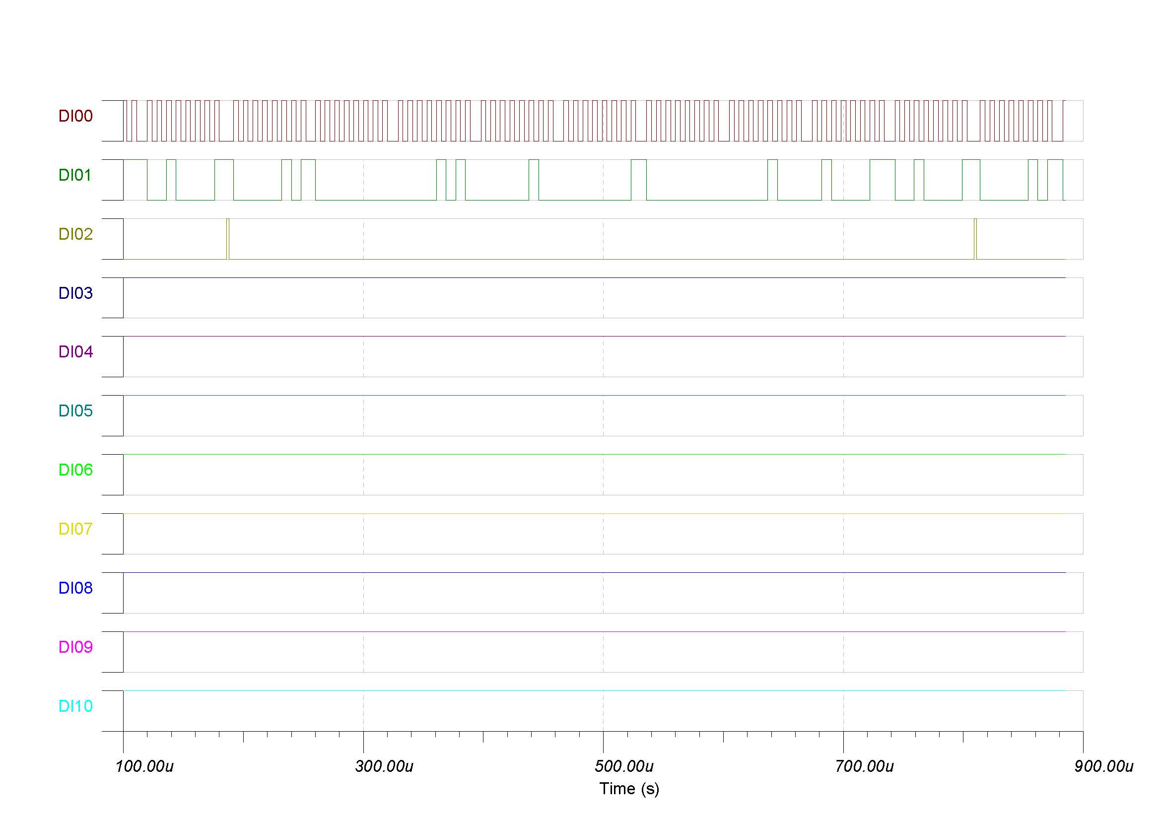

  • I add what Imanaged to do

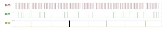

  • I had the wrong graph this is what I see with the three three byte blocksTINA Diagram2.rar
  • Massimo,
    The original posts that you showed are incorrect because each set of 3 bytes should be separated by a /SYNC pulse. Taking your original plots, this is how they should look (inserted /SYNC pulses).
    However, you most recent post shows that you correctly have the each of the three bytes separated by the /SYNC pulse (although you only show two different 3 byte communications.
    So is this what you see on the oscilloscope? What you're sending looks like TINA simulations, not a real scope plot or output from a digital analyzer. Can you get a real read from a four channel channel scope or logic analyzer?

    I did as you told me and everything works it was just about times between pulse trains.
    I thank you for your infinite patience.
    Now I just have to find the correct time.
