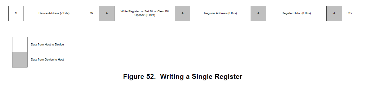

I am using the ADS7142 and about the only operation that I cannot get to successfully execute is a calibration step using the OFFSET_CAL register.
After writing that register the BUSY/RDY_BAR signal never goes high as suggested in the datasheet. For any other operation (starting ADC readings via START_SEQUENCE register, software reset via general call) the BUSY_RDY signal instantly goes high when the command is written. I have probed the following three signals SDA, SCL, BUSY/RDY_BAR using a saleae and compared them to the images in "TM4C1294 interface to ADS7142 software library (Rev. A)" and the I2C commands for calibration look exactly the same.
Are there any other steps need to get periodic offset calibration to work?

  • Kyle,
    How are you setting up the calibration?
    Would you try following the below diagram. Using
    OpCode =  00001000b
    Reg Address = 0x15
    content = 0x01
    When you say that you see an improvement after reset, how are you comparing it to when a calibration is manually done?

  • Cynthia,
    We are currently running that I2C command. The output I have from my saleae logic analyzer matches the screen grabs shown in TM4C1294 interface to ADS7142 software library (Rev. A) document for using this part with an eval kit.
    We are succesful in setting the part into high precision, I can change the oscillator settings and nCLK settings. I can send I2C commands to start sample. The only command I seemingly cannot get to function is the calibrate.
    Kyle
  • Hello Kyle,
    Can we try something to see if the calibration is in fact taking/not taking place
    Would you please:
    1)      Reset the ADC.
    2)      Apply 10mV input to the ADC, Record ADC uncalibrated output code. There will be an offset error.
    3)      Now run offset cal.
    4)      Apply 10mV input to the ADC, Record ADC calibrated output code. There will be a lower offset error.
    This will help to determine if the calibration is being done, and if it is not being captured by the ready signal
