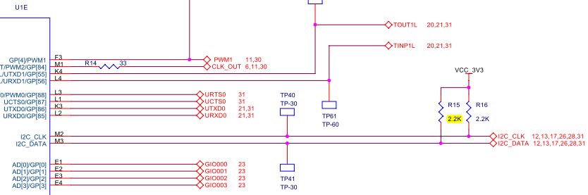

I would like to ask a question about pull-up resistor.
Regarding its value, for example, those for I2C_CLK and I2C_DATA, I have found that on Spectrum’s EVM6437 board, the pulling-up resistors for these two signals are 2.2K, whereas
1.      On another board they use 1.2K
2.      And some other people use 4.7K for OmniVision's SCCB interface (variant of I2C)
Does the value matter very much? I think as long as the signal is pulled up/down and the current is not too big, either of the above should work. Is it true?
Zheng
  • We used 2.2K on most of the TVP5xxx EVMs. You are correct, all of these values should be OK.   Larger resistors will result in slower SDA/SCL signal rise times, depending on I2C bus loading and the number of devices on the bus.
