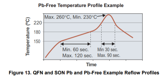

Does anybody know the maximum ratings concerning Soldering Temperature of the ADS8329IBRSAR?
Hello Gregor,
Welcome to the TI E2E Community.
Please take a look at section 5.2, Figure 13 in the QFN and SON PCB Attachment application note.
https://www.ti.com/lit/an/slua271b/slua271b.pdf
The MSL Peak Temperature for this package is 260C
Level-2-260C-1 YEAR
