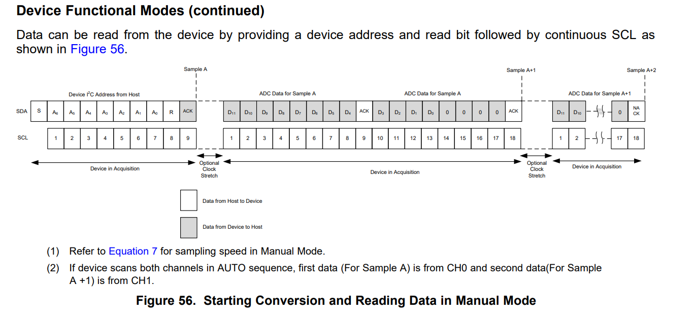

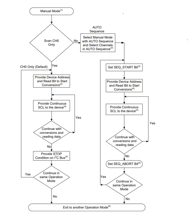

    As or your sequence, it seems correct. After you set the SEQ_START bit, do you provide the device address and provide continuous SCL? The figure below shows how to sample and read the data in manual mode

    We are able to receive CH0 data by providing continuous SCL but not CH1 data or any other register data although we configure it as per sequence in datasheet.

    You are configuring he device correctly. Are you following the chart to read the data?
    After setting the SEQ-START bit, to read the data you need do you provide the device address and provide continuous SCL.
    The figure below shows how the flow of how to read the data in manual mode.

    The problem is solved we are able to read both channels data.
    Previously we are using i2c write function to send slave address, opcode and register address and i2c read function afterwards but was not aware the I2c driver read function was designed to write slave address and register address first and then start read operation.
    Modified it to just do read operation and used i2c driver write function to send slave address, opcode and register address before calling i2c driver read function.
