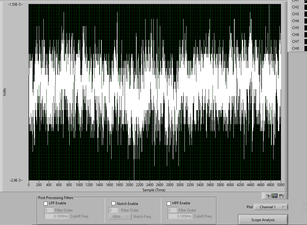

  • In support for the reduction in common mode noise, please find the attached screenshots
    I have placed the following jumpers.
    J6 (35-36)
    JP25 (3-4) and (5-6)
    This will short the ADC input with the ref and bias.

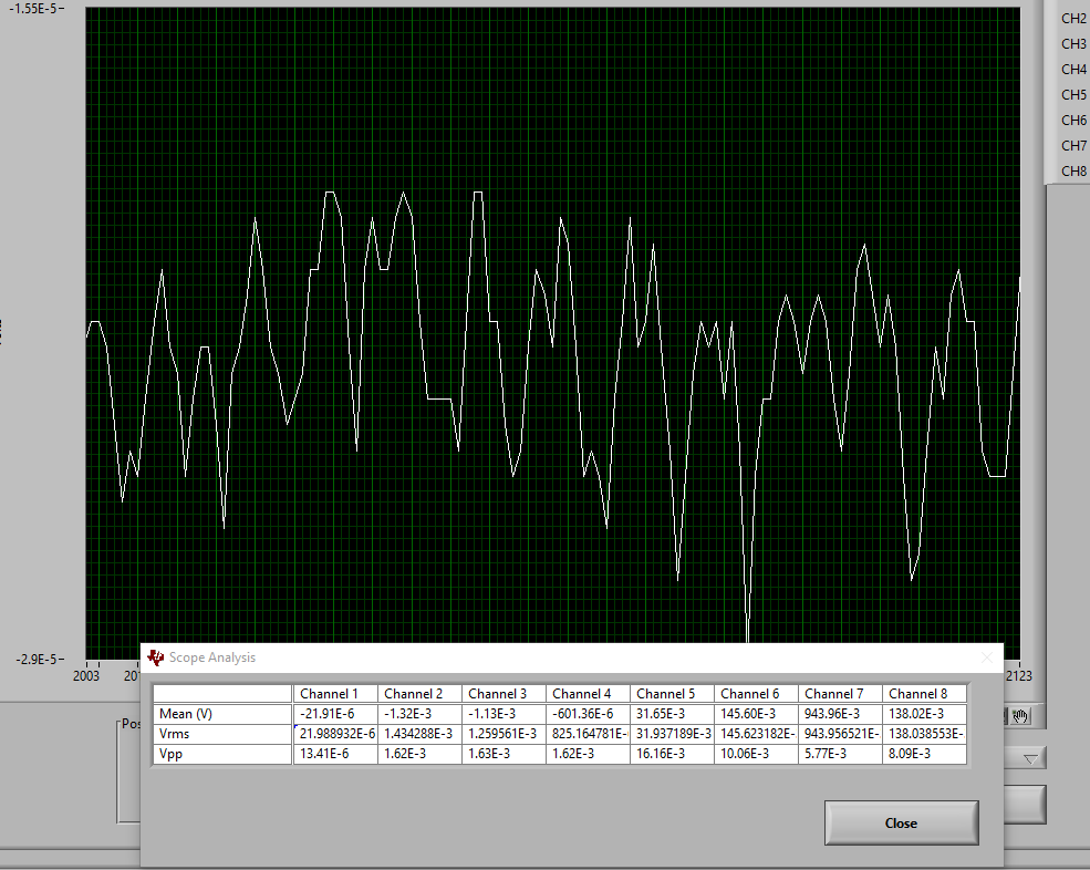

    The SRB1 is closed in the application and the readings are taken for 500SPS, 5000Samples/channel keeping the gain 1.
    I could observe a noise of around 13uV during measurement.
    Possibly this noise must be interfering with the 10uV signal that is being given.
    How do I reduce this noise?

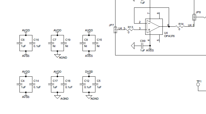

    I have mounted the extra decoupling capacitors on the ADS EVK.
    Kindly help me knowing whether the above signal must be overwriting the required signal or is there any other source of common mode noise that needs to be reduced?

  • Hello TC,
     We have figured out the noise source.
    Seems that even if we not connect AC mains to the testing setup, the 50Hz noise from the nearby mains is coupled with the signal.
    This is not reduced even if I use the notch filter.
    Any suggestions to reduce the 50Hz noise?
    Sushant
  • Hi Sushant,
    The ECG system commonly employed the use of the RLD scheme to improve the common-mode rejection and reduce the power line noise coupling into the system. I have attached the link below for the application note which show the detail of the implementation.
    Improving Common-Mode Rejection Using the Right-Leg Drive Amplifier
    Thanks.
    -TC
