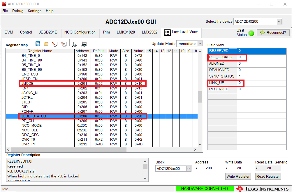

I'm trying to set up my adc12dj3200 board for JMODE16. But I always got LINK_UP =0. Here is what I do:
1) I copied the config register map from ADC12DJxx00 GUI (SLAC745A):
2)then I configure LMK04828 -> LMX2582 -> LMK04828 -> ADC12DJ3200. The LMK04828 is up and PLL1 & PLL2 both locked. And LMX2582 can generate 3.2GHz device clock. But when I check the JESD_STATUS register, I got LINK_UP = 0, like this:

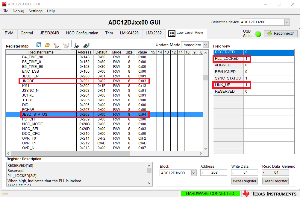

3)To compare with my previous JMODE3 setting, it looks like this:
Besides, I tried JMODE9/JMODE11/JMODE14 settings, the status of all these modes: LINK_UP = 0.

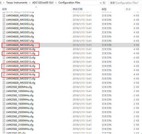

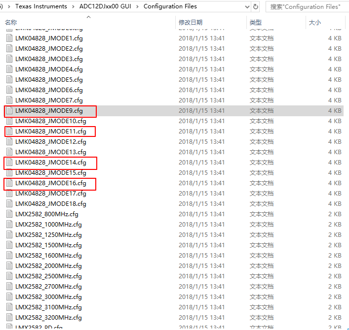

Actually, I compare all these cfg files inside "ADC12DJxx00 GUI\Configuration Files" directory, the LMK04828_JMODExx.cfg (xx=9/11/14/16) are the same one.
