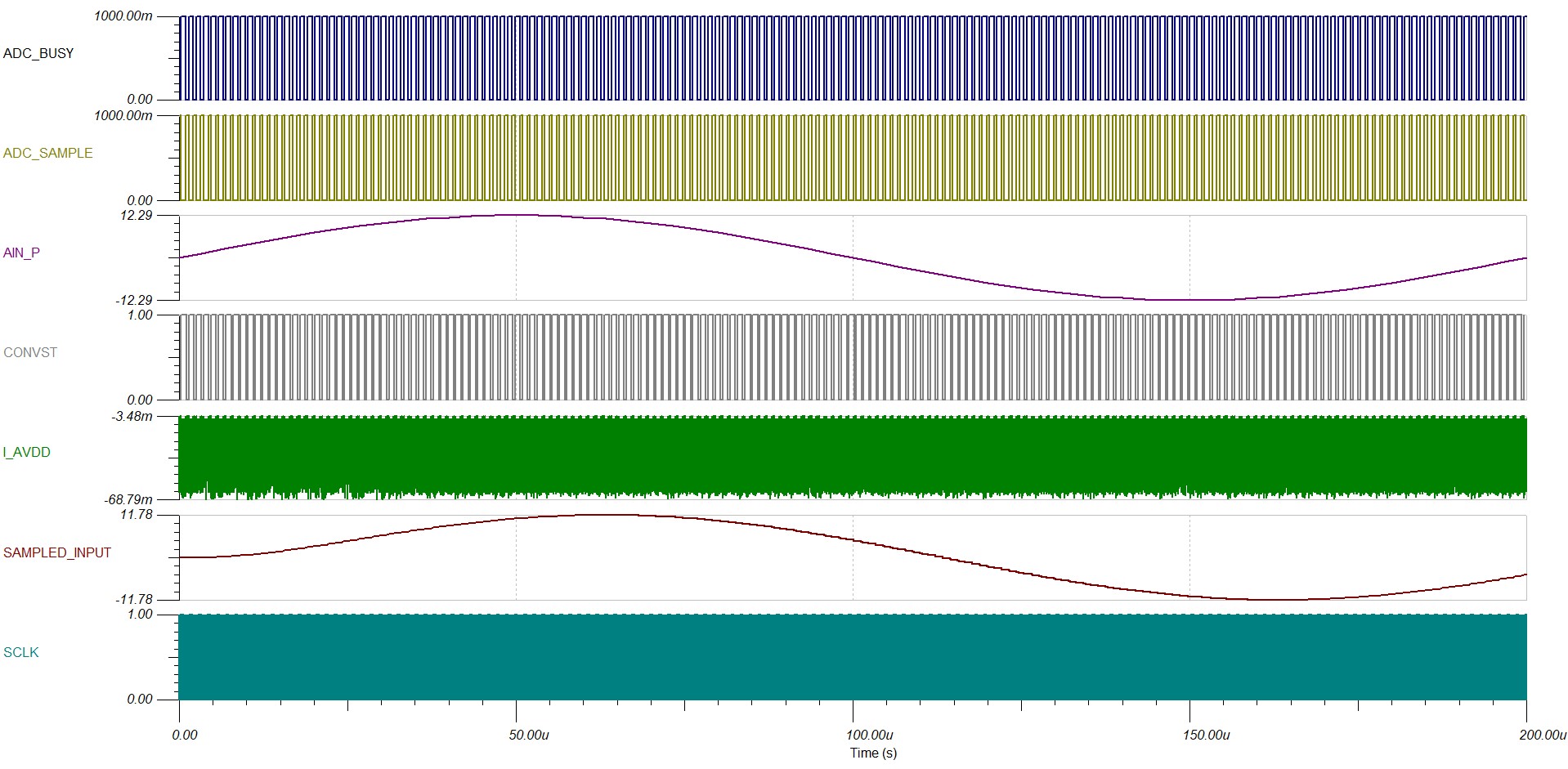

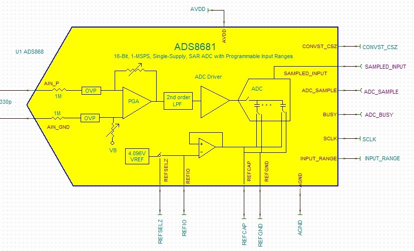

May I know which pin is the output (the signal that has been sampled) of ADC?
Is it "ADC_SAMPLE"?
Actually, I don't really understand these terms found on the TINA reference design file. I can't find these terms on ADS8681 datasheet as well.
Can explain more in details on these terms?

    The "Sampled_INPUT" is the output which is the sampled signal from the input sinewave signal applied on the "AIN_P". See the transient simulation result below.

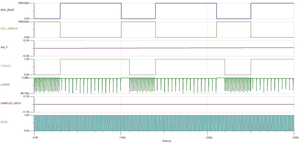

    The simulation circuit in this reference design is a simple approach to show how the ADC is working by showing the conversion and acquisition operation, also some key parameters have been modeled on the device so that you can see a dynamic change during different operation phases, for example AVDD current (I_AVDD).

    Zoom in:
