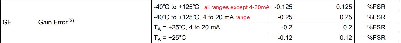

I have faced a question ragarding the accuracy of DAC8775 when set to work in different current output ranges. In the datsheet I could only find the accuracy range for 4..20mA output range.
Would you please help me figuring out how much error (TUE: Total Unadjusted Error) I should expect from the chip in 10mA / 5mA and 2.5mA output ranges ?
Do I need calbration to achive < 0.2% accuracy for mentioned output configurations ?

    My question is about the TUE determining values in various ranges for DAC8775. In reply to your mentioned point, yes the values are part of a bigger range. In the datasheet the GE value is only mentioned for 4-20mA range.
    The Current ranges that I am intended to use are 0-20mA and +/-24mA. Can I apply the same GE values (TA = +25℃) for output current values starting from 0mA up to 4mA or 0mA to -20mA ?

    Ok, I see your question. The specifications for the device are split with the different ranges. For example in the datasheet, it would have been better for us to show specifications this way:
    For the most of the IOUT ranges the TUE is the lower value. However, for the 4-20mA range, the TUE is higher. This is because of the way the IOUT is set up internally. The 4-20mA range has more error because the zero code starts with 4-20mA range starts at 4mA. This large pedestal starting point adds some additional error in implementation. That is why the 4-20mA range is specified separately.
    If you intend to use the 0-20mA and ±24mA ranges, then you would use the lower error values for the entire range.

    On top of the electrical characteristics table it is mentioned that an external reference is used " REFIN= +5 V external “. Based on the reference design (EVM),  a REF5050IDGKT is used for reference with 0.05% error.
    Does the Gain Error value include the 0.05% reference error? Or, is the reference error included in given information in the datasheet?
    Best Regards
    Erfan
  • Erfan,
    The gain error does not include the error from the reference. The reference error is separated from the gain error in for the electrical characteristics table. This is a standard method for calculation.
