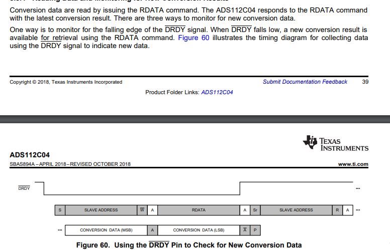

    I write the code according to the datasheet. I have one doubt if I need to read the data in continuous conversation mode I need to monitor the DRDY input.
    Please let me know could I start the data read. In the datasheet, they mention like Whenever DRDY goes LOW indicates new data available.
    Whether I need to send the start and followed command only when DRDY when to LOW?
    When the DRDY goes high? because in the datasheet it is showing RDATA 'A' bit DRDY going HIGH state.

    1. Send the WREG command to set the mux to AIN0-AVSS 0x80 0x40 0x81 and i given stop  . Shall i wait until the DRDY goes low for sending start followed by command 0x80 0x10 0x81 {__________} ,{_________} data read ?
    Nareshreddy

  • Hello Bob B..
    Thank you for replay back to my email..
    Now i am able to get the ACK from the ADS112C04 . every command which i wrote .
    steps i am following :
    1.reset the ADS112C04 by issuing below command
    <S>0x80 0x06 <P>
    2.i am tring in the single-shot mode it is set as diffault.
    3. i am writing to ANI0 by follows
    <S> 0x80 0x40 0x81 <P>  // WREG command to set the mux
    <S> 0x80 0x08 <P>           // ADC START/SYNC conversion command
    Monitor DRDY and wait for DRDY to transition from high to low
    <S> 0x80 0x10 <Sr> 0x81 {MSB byte} {LSB Byte} <P>  // RDATA command and data returned from ADC
    4.after read command i am sending for AIN1
    <S> 0x80 0x40 0x91 <P>  // WREG command to set the mux
    5.after read command i am sending for AIN2
    <S> 0x80 0x40 0xa1 <P>  // WREG command to set the mux
    6.after read command i am sending for AIN3
    <S> 0x80 0x40 0xb1 <P>  // WREG command to set the mux
    after last channel again i am repeating the step 3 .
    But for me DRDY pin is not moving to High to LOW . it always high only .
    Naresh reddy
