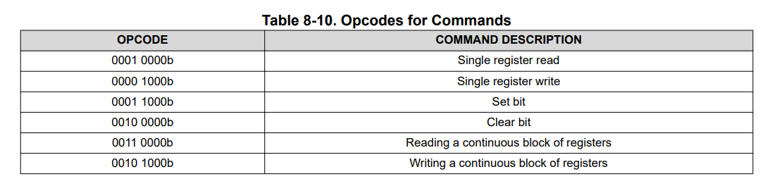

Are there driver's or examples available to create a Labview or Python interface for the TI ADS7138-Q1 Automotive ADC with I2C ? Thank you.

Unfortunately there are not any sample codes available.
The EVM for this device has the ability to export the register address and content based on the device used through the user friendly GUI and EVM. This should be helpful as to how to configure the device based on your configuration needs.
I will point out that this uses op codes which is not common I2C protocol, I have seen this been overlooked by others and results in communication issues.
