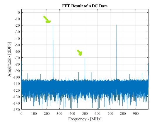

I would like to ask a few questions about TI's ADS54J60 chip, if possible. We have a problem with obtaining SFDR values which are denoted in ADS54J60 datasheet.
 - We use 250 MHz ADC reference clock, which is the output of LMK04828 chip.
- SYSREF pulses are generated using LMK04828 either. We calculated the SYSREF frequency from SYSREF = LMFC / 2^N. By selecting N=4, (fs/4)/K => (1000/4)/16 = 3.90625 MHz.
- We use 4244 LMFS configuration and corresponding DDC mode & JESD link properties given in datasheet. You can find our register configurations attached (adc_config.txt).
- Fs/4 noises seem acceptable (approximately ~90dBFS).
 However, our SFDR is not as fine as datasheet offers. Even if a 0 dBFS signal is applied, our maximum SFDR is around 53 dB. We always observe a harmonic spur (I think it is a second harmonic, aliased somehow) which has 2x bandwidth of original signal.
 I also attached the spectrums of ADC output signal. Do you have a suggestion to improve our SFDR performance? I can provide additional information about out setup if it is required.
 We have a secondary problem, last two LSB output bits of "channel A" are stuck. Depending on the input signal frequency, it is always stuck at some value ("00","01"..). Am I missing something in register configuration?

    What tones are you testing at? The device will saturate with 0dBFs inputs. Are you using bandpass filters with the analog input? All data sheet numbers are taken at -1dBFs. Please send your register settings.
    Jim
  • Hi Jim,
    Please see feedback below and attachments:
    - 500MHz to 1000MHz single tone frequencies are tested (Output of analog signal generator - Agilent N5171B), no bandpass filters are used with the analog input.
    - Spectrum outputs for input frequencies of 650MHz, 700MHz, 750MHz are attached (-20dBFS).
    Thanks in advance

  • 650MHz input tone.pptxFurkan,
    The register settings look Ok except for address 0x005500. If they want to turn off CHB this needs to be set to 0x10 not 0x00 as they have it. They need to capture data using a bandpass filter as I think this is their issue. Attached is data captured I did from home without a filter. If I had a filter, you would have seen a big improvement. Not sure how noisy their source is. The next time I get a chance to go to the lab, I will duplicate this test with a filter.

    I think this transformer is ok to use. Using a transformer with a max frequency of 1000MHz will still pass higher frequencies'. They will just start to attenuate as you go up in frequency. I would try the bandpass filter first.
    Jim
  • Hi Jim,
    You were right, bandpass filter has solved the problem. Now, SFDR performance matches the product specification.
    Thank you!
    Dogancan
