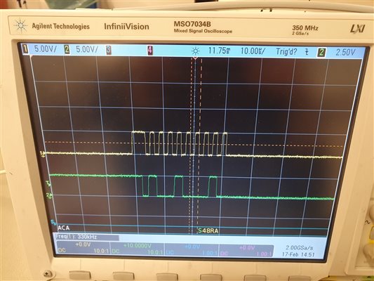

We have a design where around 1 of 8000 I2C transactions towards ADS7828 results in SDA line gets stuck low.

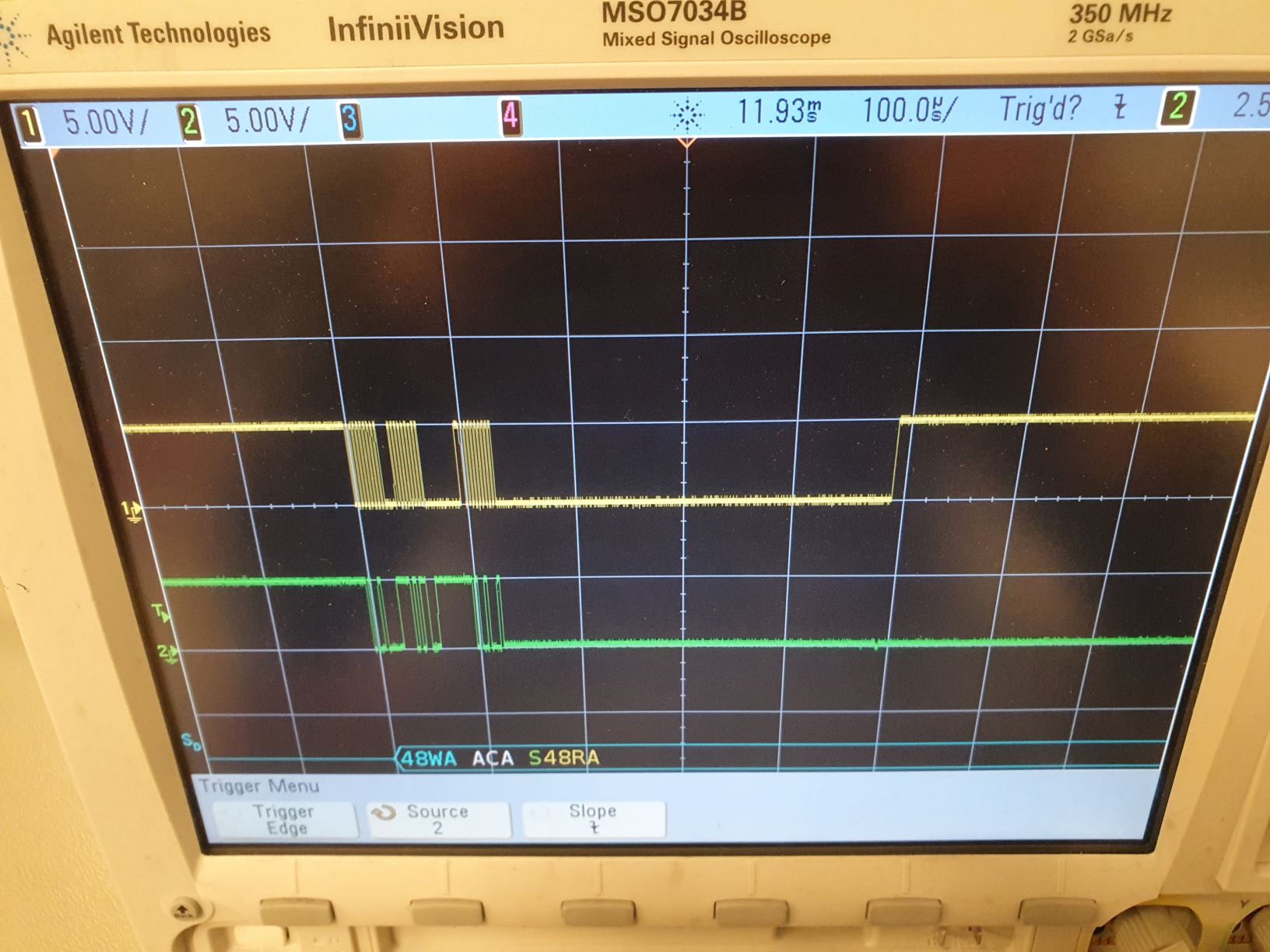

I managed to capture a transaction where this occurs.
After a repeated start, it never releases the SDA line after address ACK.
What can cause this?
Transaction:
Close up:
Measured timings from the frame in question:
f_scl = 330 kHz
t_buf = 100 ms
t_hd,sta = 1.40 us (start)
t_hd,sta = 1.45 us (repeated start)
t_low = 1.46 us
t_high = 1.38 us
t_su,sta = 3.0 us
t_su,dat = 740 ns
t_hd,dat = 340 ns
t_rcl = 120 ns
t_fcl = 260 ns
t_rda = 120 ns
t_fda = 260 ns
t_su,sto = inf

  • Hello Gaute,
    When issues like this occur, it has historically is the host that originates the issue.
    The second image you shared zoomed up only shows the last frame, can you confirm that the previous transaction ended with an acknowledge from the ADC?
    The last frame also shows the stop condition with the SCLK going back down and releasing it until much later, can the host release the sclk after the stop condition to idle high.
    Cynthia
  • Hi Cynthia,
    Thank you for replying.
    I can confirm that in the last frame, the previous transaction ended with an acknowledge from the ADC.
    The reason why SCL is released after a long time is because of a timeout in the host driver.
    In the last transaction I was assuming that the ADS7828 acknowledged its address and never released the SDA line after that. But it may just as well be the master that holds the SDA line low. After some more debugging I think I have discovered a race condition in the host I2C driver that could explain this. I need to do some more testing to confirm this...
